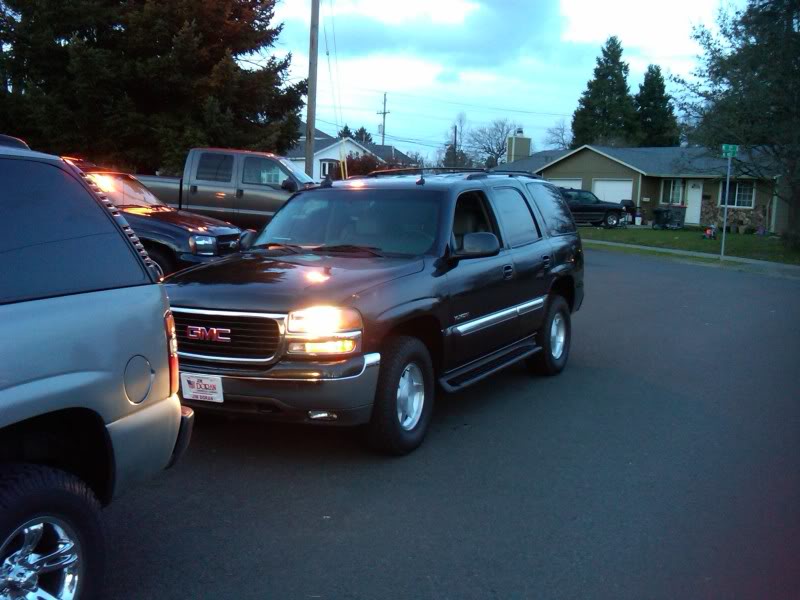

The color is a sort of charcoal grey metallic.....
A couple pics. The gold one in front is my Dad's nearly identical '03 SLT...
