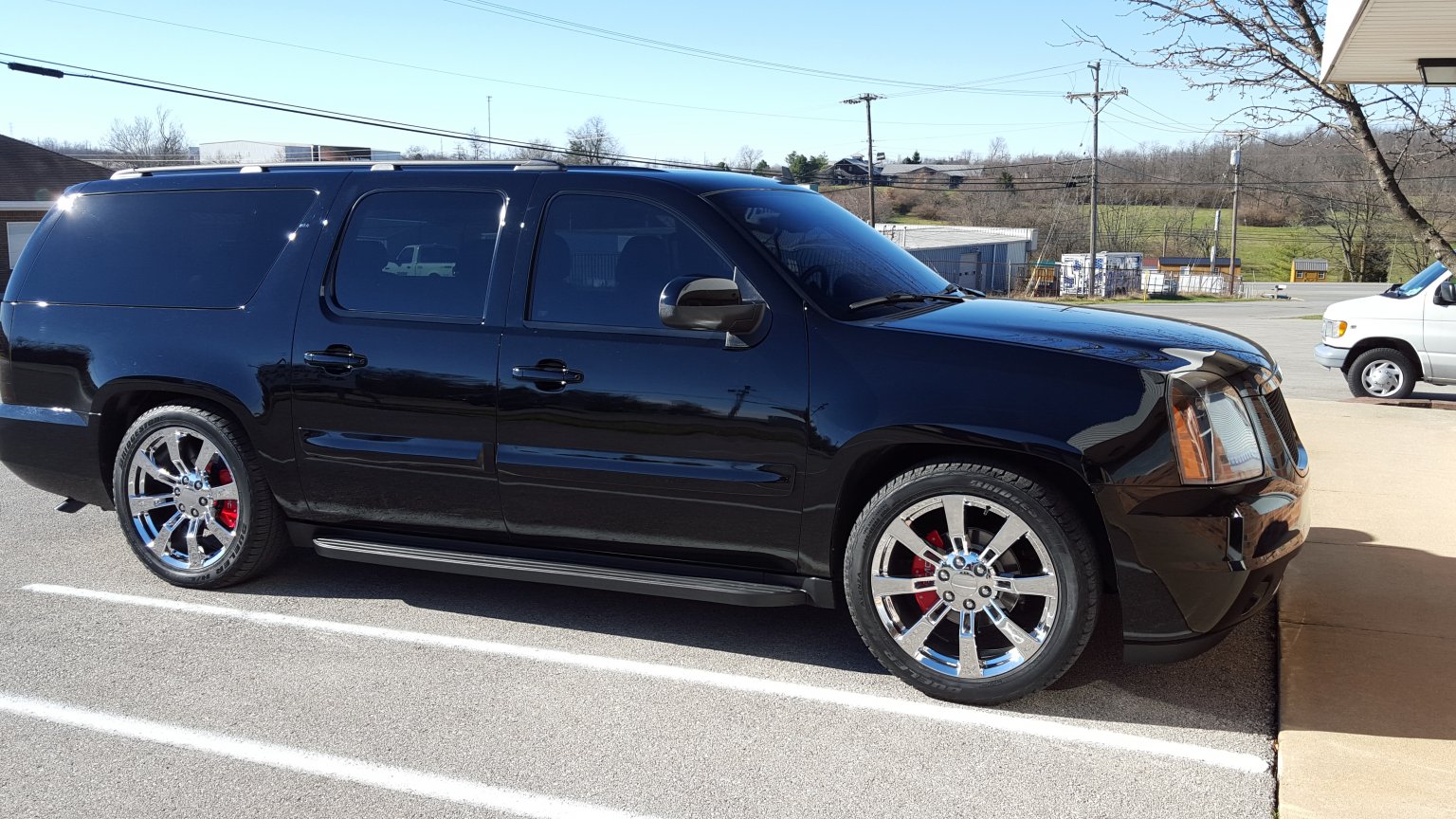

Just finished my 4-6 drop

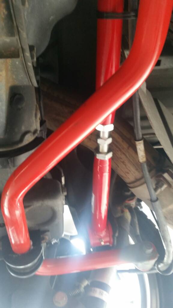

For anyone curious as to what Norcal setup looks like with a Spohn panhard bar and air ride helper bags here's your chance. Spare tire obviously removed for more room to work.

What does the panhard bar do?
Once you lower these vehicles so far, the adjustable panhard bar lets you re-center the axle under the frame/body.
