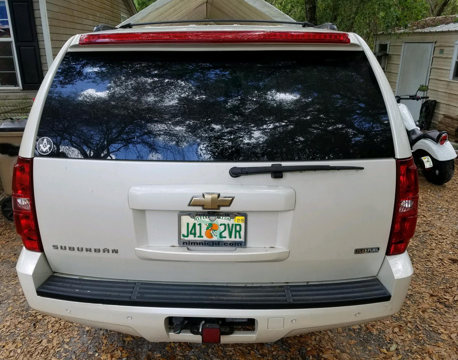

Then I picked up a ready to mod Esky 3rd HMSL and spoiler from Lee @goodinblack for a song :signs6:
When I received it the spoiler was black... imagine that... so I had to paint it with the WDT 3 stage paint to make it match the Burb.
rps20180125_220552_707-jpg.191431
I decided before I ever bought this from Lee that if I ever did the Esky 3rd, I was determined to do it differently from everyone else's. I know what your thinking, "having a full width modded Esky 3rd is already different" , and you are right... there are but a select few (in the overall grand scheme of things) that have it, BUT I wanted to be in the .0001% club.... lol
So I decided to integrate turn signals into it while still allowing for the brake function... kind of like the "line of fire" LED strips under the tailgate of a truck... certainly NOT an original idea, BUT definitely an innovative and original execution in my opinion.
Since that video I have actually replaced the top brake light bulbs with another set of the strobing bulbs I have in the "new" lower brake light so I guess I need to get another video.

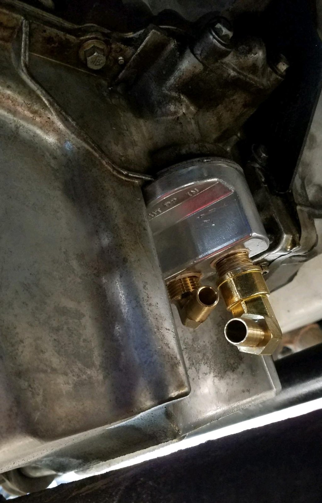

I don't really have any pictures of the tear down and rebuild and even if I did, who wants to see the inside of an old engine any way so I will skip ahead to what all I did.
I needed to replace my engine mounts anyway and I wanted to remove the screen that lives below the oil pressure sensor.
I decided the easiest way to accomplish all of my goals was to pull the intake manifold to both make it easier to get to the screen under the oil pressure sending unit and it would allow me more room to lift the engine up with my cherry picker giving me room to swap the mounts AND give clearance to remove the oil pan WITHOUT having to drop the steering rack.
I dropped the pan and pulled the balancer, water pump, and timing cover, R&R the oil pump and timing chain and also the pickup tube's O-ring which to my surprise was not broken and actually came off in one piece. I also replaced the pressure relief valve that resides in the oil pan near the filter. I had purchased the new PRV and the shield that goes around it because I wasn't sure if that recall had ever been done to it. When I got the pan off I realized it already had the shield but I replaced the PRV anyway just to err on the side of caution. The LS2 timing chain I installed was an upgrade from the stock chain and fit without any modification necessary.
After all of the internal work was done I turned my attention to the engine mounts. I wanted to go ahead and get them swapped before reinstalling the oil pan to give me as much room to work with as possible. They were a little bit of a pain to get the old bolts broke loose but overall it wasn't that bad. With the new mounts securely in place I proceeded to button up the front and bottom of the engine with all new gaskets and seals. Reinstalled the harmonic balancer with an upgraded aftermarket crank bolt that is NOT a torque to yield bolt... I hate those things.
Back up top I removed the screen under the oil pressure sensor and reinstalled the sensor. I removed the TB from the intake and thoroughly cleaned all the oil out of the intake manifold....
THANKS GM AND THANKS EPA FOR MAKING THEM DESIGN IT THIS WAY!
Obviously I am referring to the routing of the PCV back into the intake which causes oil consumption issues and completely coats the intake in oil.
Anyway after cleaning everything to the best of my ability I reinstalled the TB and intake manifold with all new gaskets along with new gaskets for the valve covers as well just for GP.
After getting all the belts and hoses reinstalled and topping off all the fluids and installing a fresh oil filter to go with the new oil. I turned the key to the on position a couple times to prime the fuel rails and turned the key and guess what???
