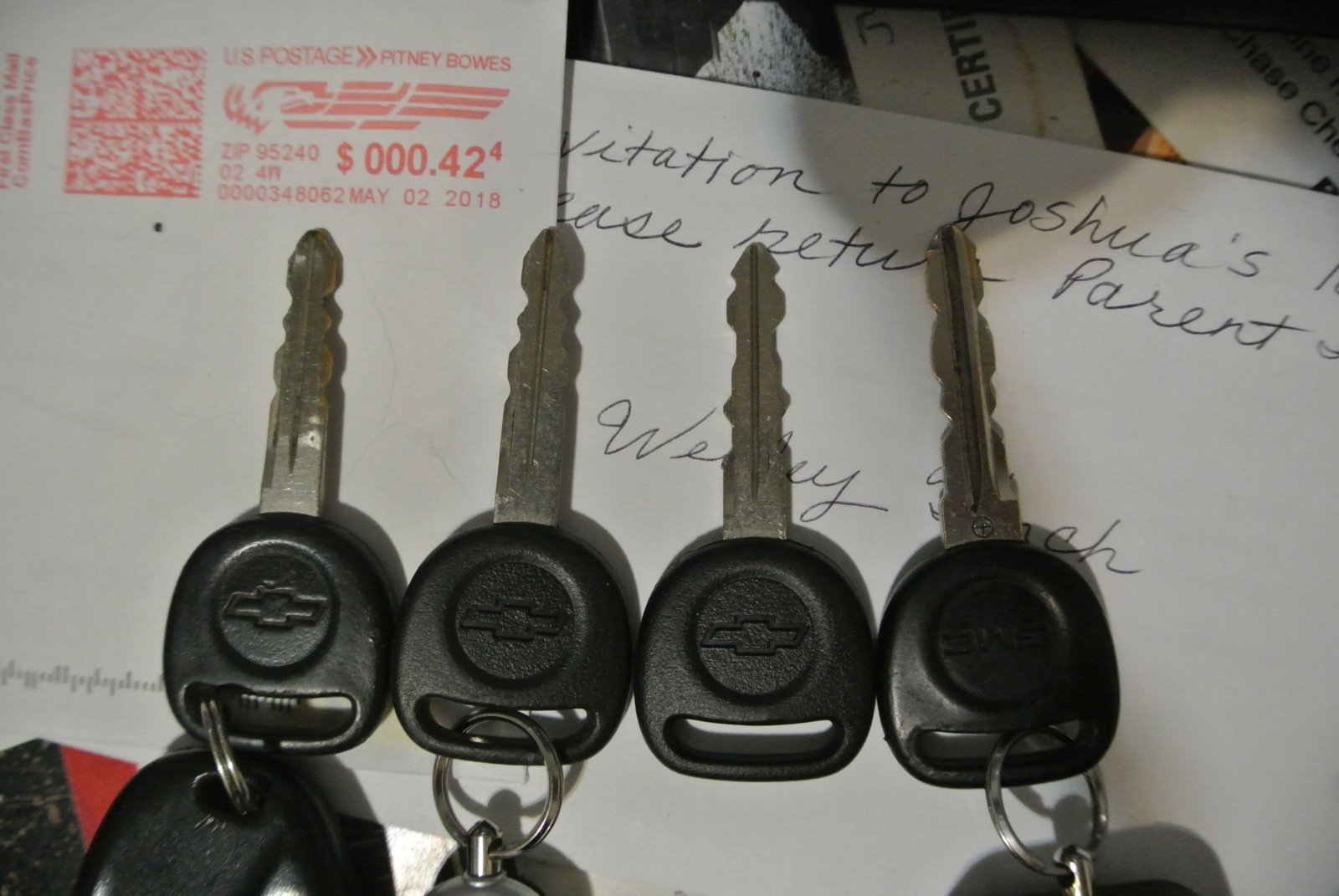

these are keys from a 03, 04, 12 if your key has a (+) symbol on the metal part then it has a chip, the chipped key can be programmed yourself no need to pay to have it programmed.
