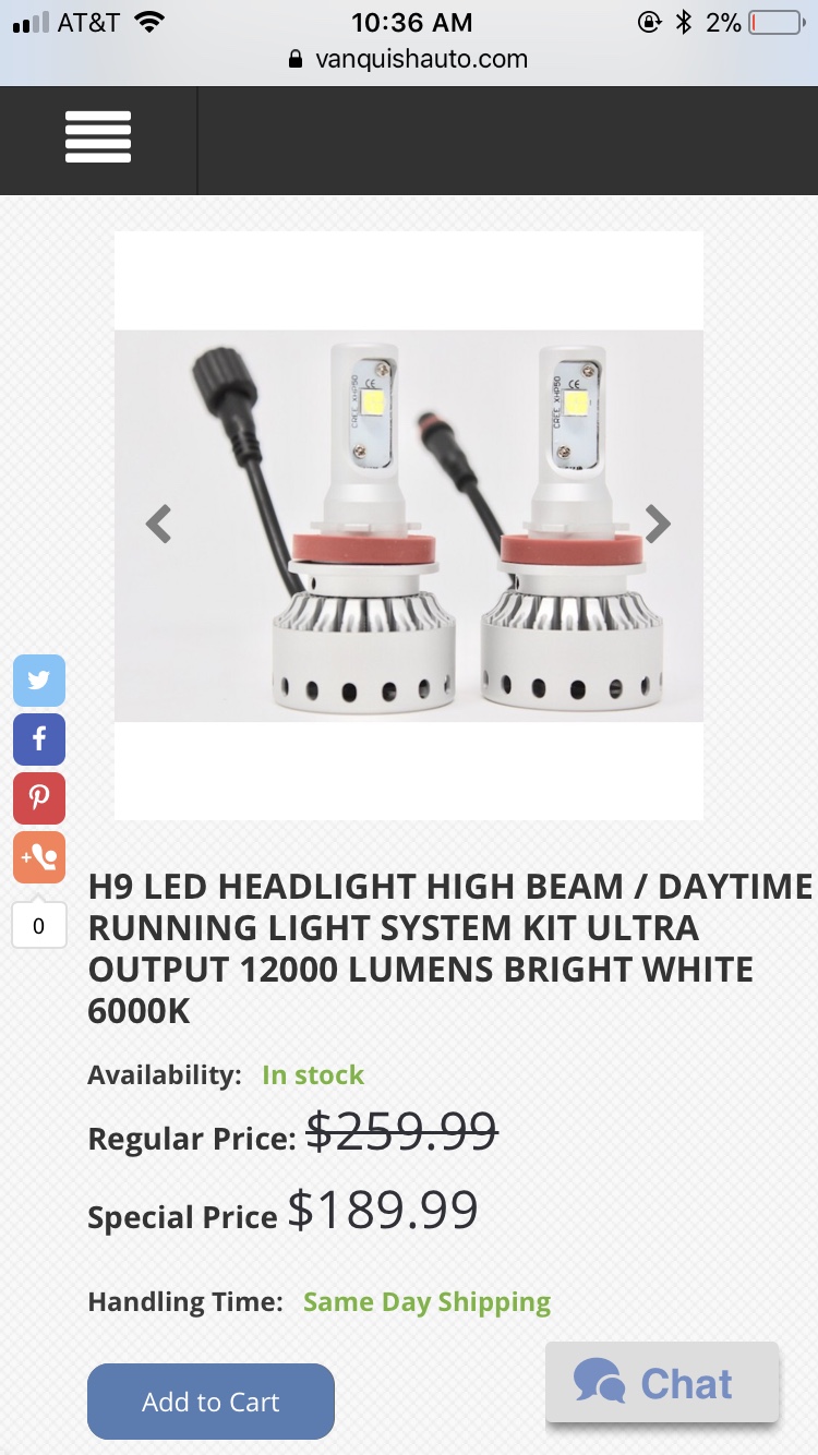

Hello. Our led kits has been proved as the most powerful led bulbs for any vehicle application.
We have the brightest bulbs for headlights with 12000 lms with 5 years warranty, here is the link in case you may want to take a look at it.
https://vanquishauto.com/led-headli...a-output-12000-lumens-bright-white-6000k.html
Thanks.

Ours has been the smallest led kits ever! Said for many customers all over the internet with super good results!

Here is the problem with the braided system. They don’t light up any good. It’s one of the cheapest systems out. But glad they worked for you.

Just giving my take on the braided system. Not trying to disrespect and I’m sorry if I did.
I just got in my hand the latest headlight bulb with csp( we use them for back up lights, they are crazy bright) and it didn’t do the trick for projector headlights. Gave up at a good 80% of the light output of halogen. Tested them on reflectors and gave it that flash light beam pattern and also lost brightness and output from the halogens. Still every other seller will push them as the hottest right now. We are about selling the single best option vs driving you mad with the countless gimmicks that show up every other day. We only want the best. We have been testing led headlights for years before it wasn’t even a thing people would talk about. Just waiting for that single bulb to be worthy of a halogen reflector.
