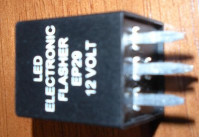

Hello all. New to the forum and hope I have the right one.
I have an '04 Denali where I just installed LED's in the front turn signals only. The flash rate is now irratic. After doing some research I read someplace where I needed an LED flasher unit. I found one at Super Bright LED's. LED Flasher Unit EP29L. I cannot for the life of me figure out where this thing goes, or if I even have the right thing. I've searched the owners manual and online. :emotions122: Any help would be greatly appreciated. Thanks, Chris

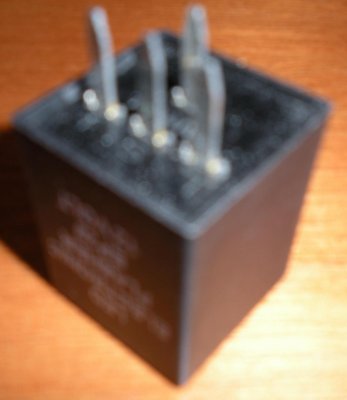

Thanks, it does help. But here is where I'm confused.
The Super Bright LED's website said this is what I needed, the EP29L LED flasher unit. It also said one should "definitely use one of these instead of load resisters", their words. I bought into it and ordered it, $20 shipped.
When it came, I got my manual to figure out where it goes, under the hood or beside/under the drivers dash. When I couldn't find it, I found this online in another forum: http://ryoogle.com/LED/tahoe-hyper-flash-fix.php According to this, the flasher unit has 10 prongs on it and it's behind the fuse panel to the left of the dash. The one I bought has 4.
Is there another one somewhere that I don't know about? I live in Chicago, it's 15* outside and I don't have access to a garage at the moment. I originally thought the flasher unit I bought would go under the hood, it looks like it would, but the prongs aren't set up that way. I have no problem buying the resisters, I just figured if super bright said this is what I needed for an '04 Denali, then there must be a place for it.
nope, they just sold you the wrong thing. Doubt anyone makes a flasher module for NBS or NNBS... just for the old school ones that work on most everything.
