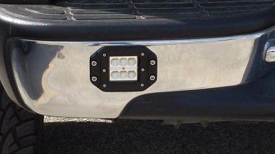

I bought some flush mount LED fog lights I plan on mounting on my rear bumper. I've got 5% tint all around and it's hard as hell to see anything while backing up at night.

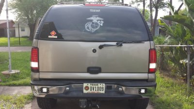

Installed these a week ago to help out with backing up... BIG difference in light output!
