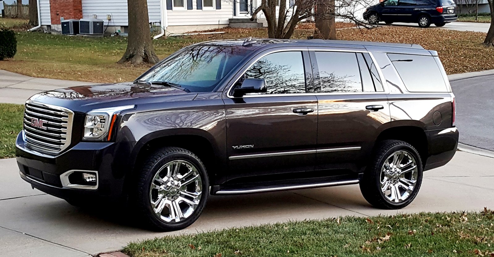

I've searched and browsed through most of this thread and still looking for an answer...
I installed 6500k 36w LED's with cooling fans, both high and low beams, in my 2018 Yukon SLT.
They are bright and perfect.
Did anyone DRILL HOLES IN THE DUST CAPS, for ventilation and air circulation. (I did this on my 2014 Silverado, because it was recommended my other forum members, but no discussion on that here).
Thanks, BillView attachment 190059

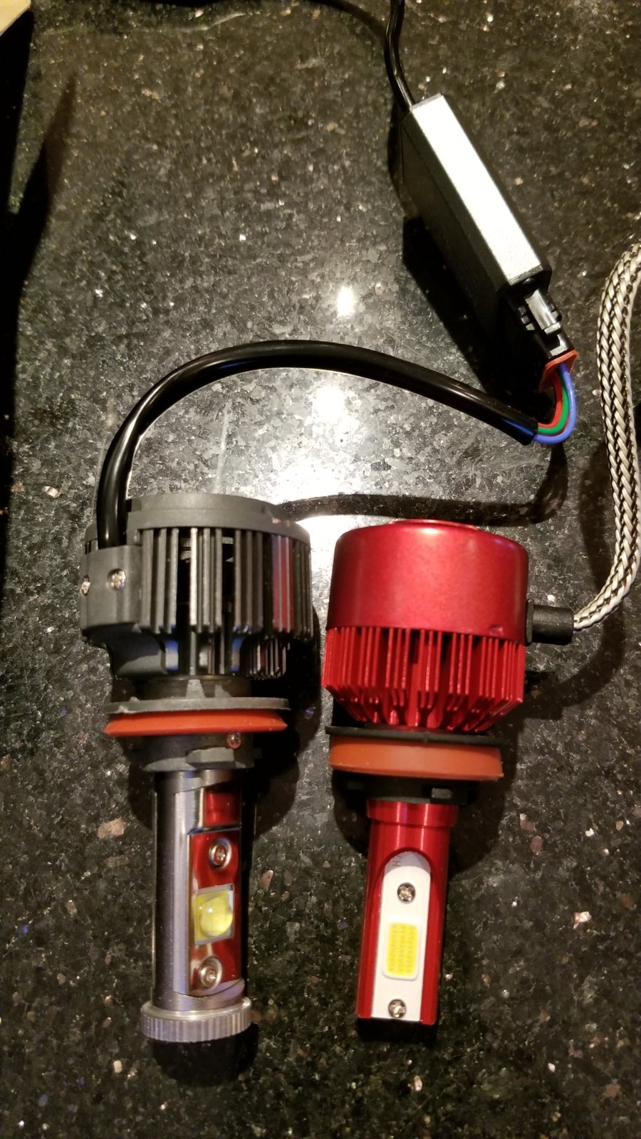

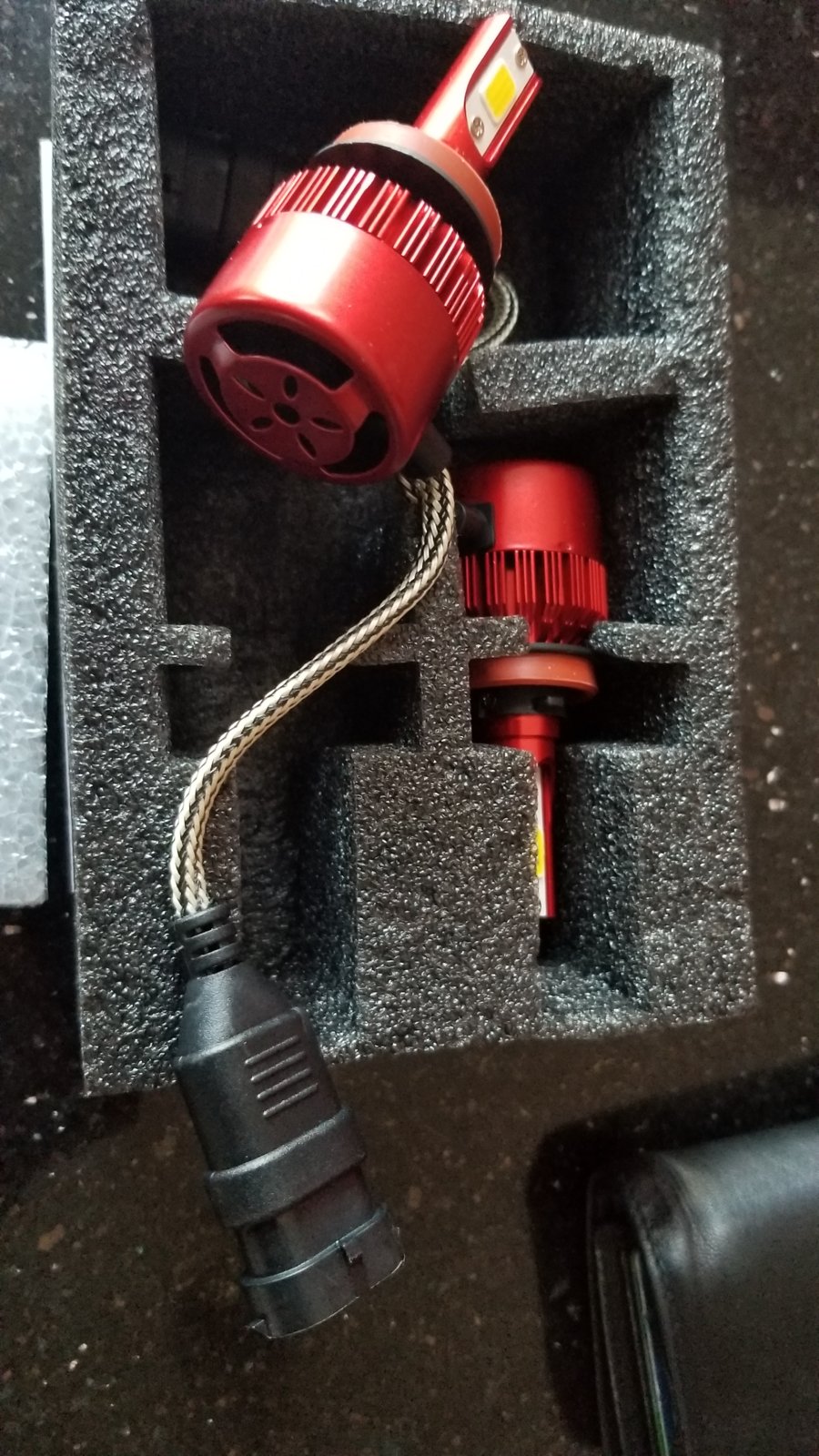

So I ordered a new set from Xentec
(Ebay). Was going to install them today but they look a little different than the ones from Mostplus. I thought I was missing a piece but my buddy tells me the inverter is built into the fan on this one. Now I started to worry about the size(longer) but they looks pretty much the same.
20180202_165418.jpg 20180202_165409.jpg 20180202_163123.jpg 20180202_162956.jpg 20180202_162937.jpg

The concern about the length that I would have is...
Measure the length from the rubber sealing grommet to the mid-point of the LED's and compare them between brands. Where that LED is compared to the seat will make a big difference on focal point within the lense and how the light output is/looks.
