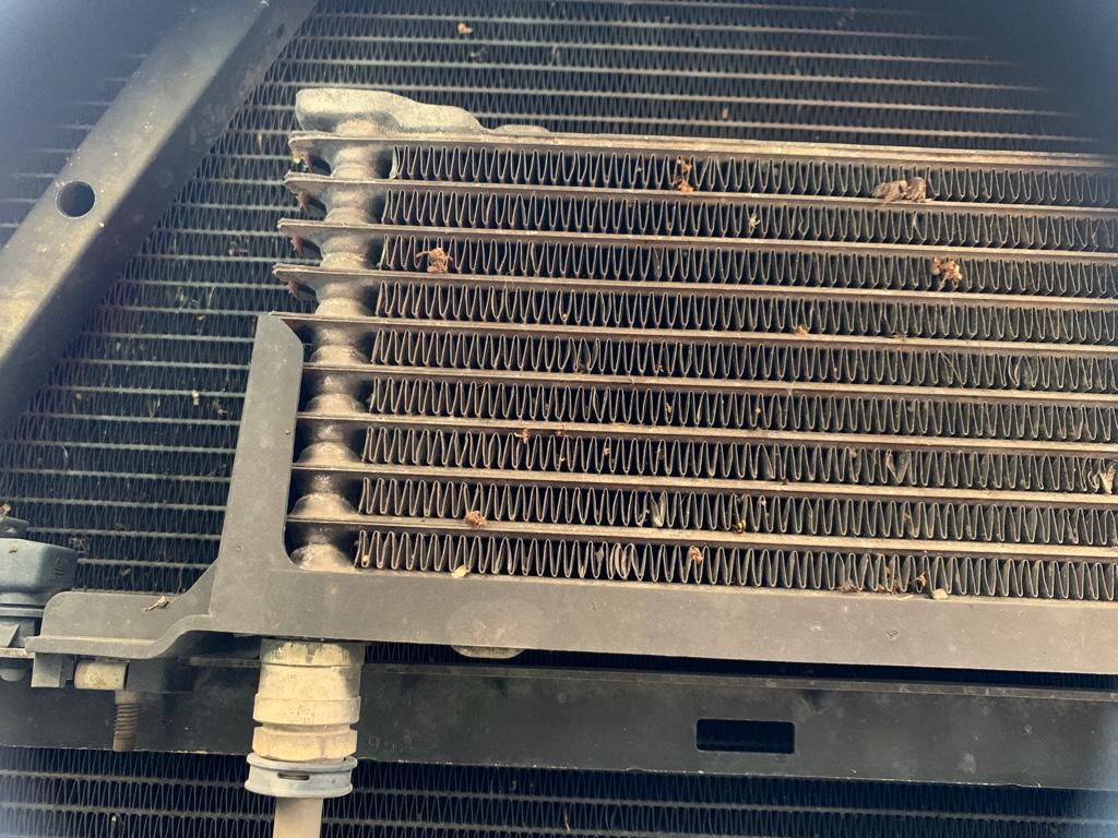

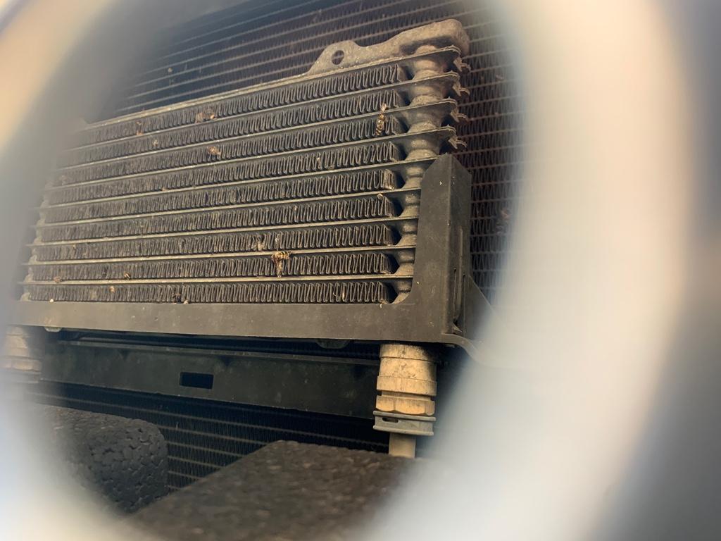

I have a 2009 Yukon Denali XL that I tow our boat with. Boat is 3600lbs dry and trailer is roughly 1500lbs so I am at 5100lbs. My normal trans temps with no boat or trailer are usually around 160-170 degrees F in the summer. I have noticed when towing the temps are obviously higher. I am usually around 190-200 Degrees when towing in the summer. I am in Illinois so roads a relatively flat and I tow about 30 miles each way on the weekends. There have been a few times trans temps have gone up around 205-210 Degrees F. They usually come back down over time but is there anything I need to be worried about?
My other concern is I am going to be towing from Illinois to Missouri roughly 450 miles, in May. The Yukon does have the external trans cooler, but it looks small. Should I look into a larger cooler?
Should I look at draining the trans fluid and swapping with something different?
Thanks for the help
I towed my 5300lb dry weight boat all of last year and also taken it to Branson with no issues. I had concerns about my temp as well but on the highway it never went over 200.
