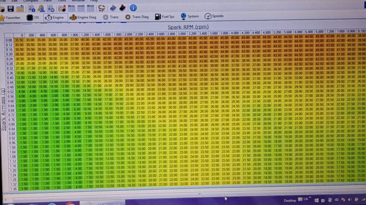

just for the heck of it.. here's a pic, hopefully it's not to blurry of my 6.0 hybrid high octane timing map and my ls3 c6 stock maps. not that you'd want to run these, just a visual of why I'm supised you're seeing 30 plus deg. 3000lb car with a ls3 doesn't even run that. and I've since pulled 2deg from this map for hard driving, it just feels smoother, might give up hp thou. I just saw it talked about somewhere, tired it and was like huh, engine seems happier so I left it out.
Second one looks pretty similar to my timing map !! I'm sure that there are
some spark adder modifiers that come into play as cylinder airmass changes.
Ive re-smoothed several cells in mine and taken out 1-2* here and there..
