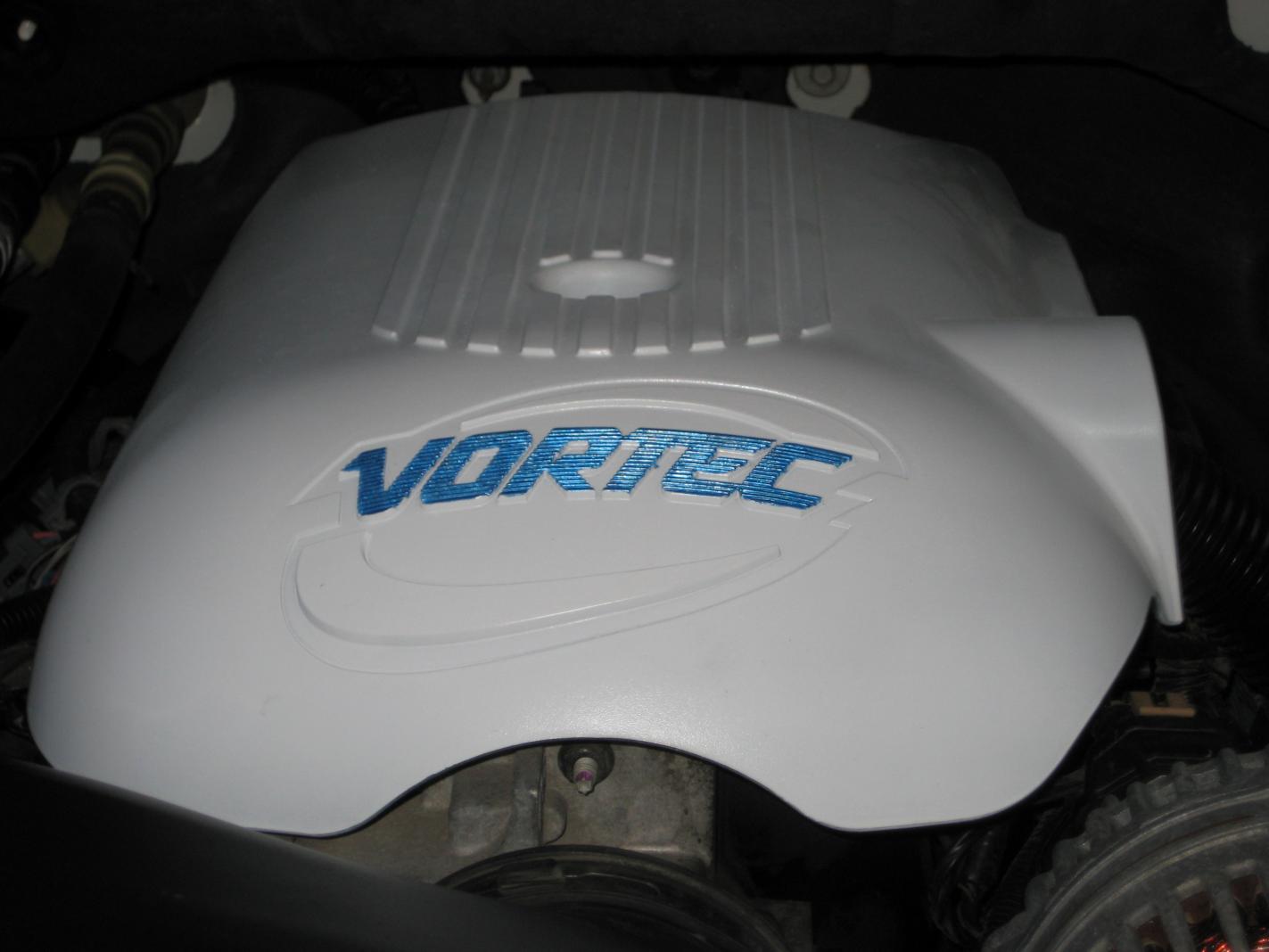

man the painted engine cover looks awesome! how hard was it to get the paint to stick?
Would like to know as well! SOme type of high temp rattle can paint?

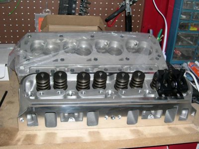

picture.jpg mine
---------- Post added at 10:34 PM ---------- Previous post was at 10:33 PM ----------
i did alittle more work just got to take pics

thanks!! Ya, the E-fans was the best thing so far, as far as engine dress up-owe ya, it also helped ALOT!!! I actually made them myself, instead of buying the $300 silverado e-fans, went to junk yard, bought some 13" fans, made some custom brackets, and walla!! turned out pretty good.
As fas as painting the plastics. Had my neighbor spray the coolant, brake and electric box plastics, did it cheap was the only reason. But for the middle vortec plastic cover, e-fans and some other plastics, used Krylon plastic paint with High Temp clear coat. So far, so good. Been on there for about 3 months now, with absolutely NO peeling, cracking, chipping, fading, yellowing, NOTHING!!!. If your not gonna use a plastic paint, and just a High Temp paint, make sure to sand thuroughly, use prep spray, and usually a paint inhebitor is the best bet. Also primer!! But gotta say, have used Krylon's plastic paint on alot of other stuff off the car, and it works great!!! Doesn't really get hot enough to peel paint inside engine bay, unless really close to headers. from my experience

real easy to do, just prep, prep, prep!!! But plastic paints like Krylon work very well for that. I have tried other brands of plastic paints, but Krylon seemed to be the best, IMO. Always stuck well, and never any problems, and could always go back and touch up with no problems unlike Rustoleum. From personal experience that is. Blue would look good, have been thinking about adding some color, but not sure yet.

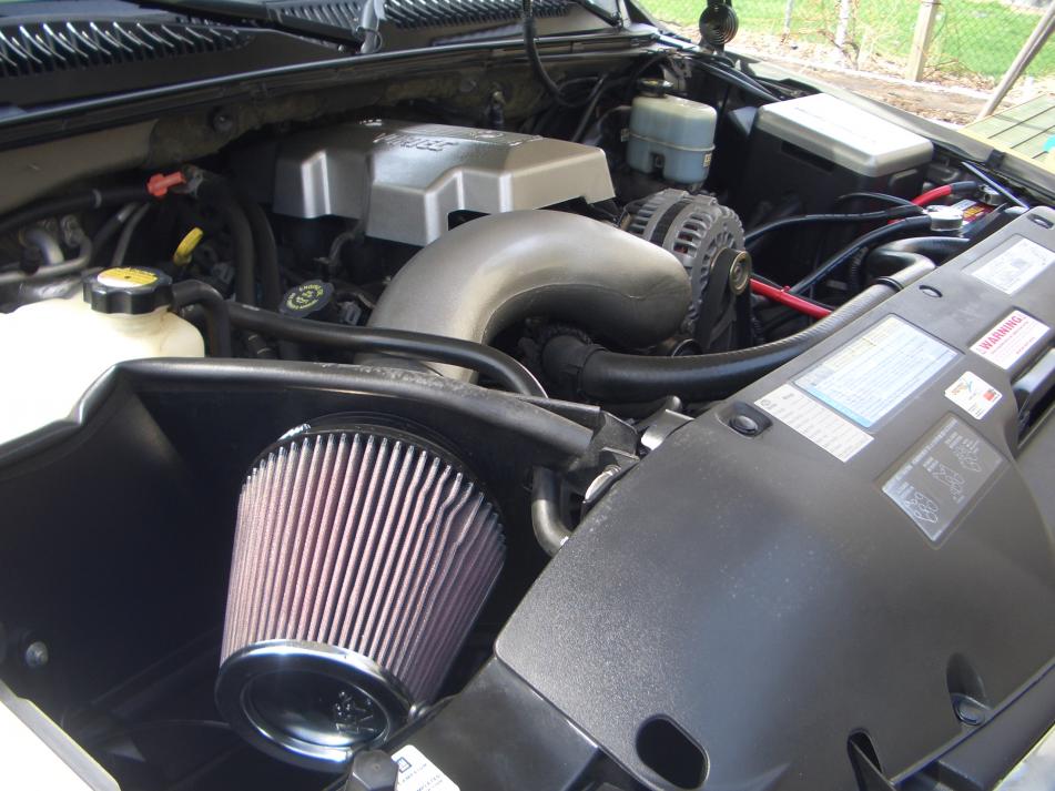

Just installed
Thanks to Max's advice.
Looks good, sounds good, and adds a little pep. I added the sticker. I am just excited about not having to go to store for a filter. And even more excited about not having to oil it. Just simple green it, hook it up to a shop vac, and watch it dry quickly.

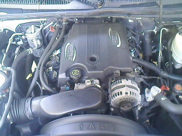

Just a simple Intake, but i think it looks damn good for 174,*** miles.
