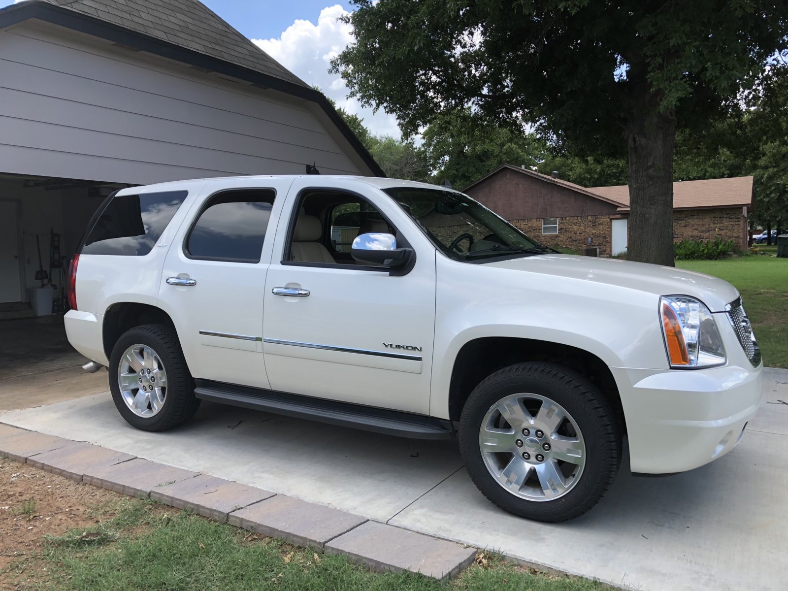

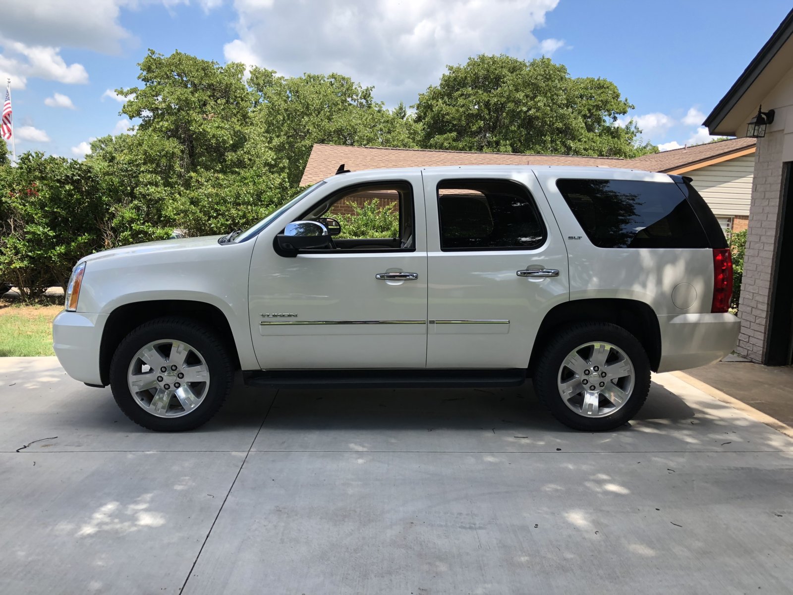

Escalade Premium Package with a "Suspension Maxx" 1.5 front level lift.
Here's a link to the product info,
https://www.suspensionmaxx.com/store/product/SMX-GM715
Great guys to deal with you have any questions.
Super Easy to install, did everything my self from start to finish (including getting and putting tools away) in about 45 min. After the install, a quick front end alignment and you are done!! Big improvement over stock with regard to the look!! Personally, this is the way they should come from the factory.

It appears you have a platinum package, not premium.

Thanks,
But it is actually the "Premium" package.
The Platinum has the all silver grill, chrome on the side moldings, chrome fender vents, chrome door handles and the wheels are chrome. The interior is also different on a Platinum as it has the upgraded seats.
The Premium has the two tone, painted / chrome grill, painted side molding, two tone fender vents, painted door handles, two tone wheels and standard interior.
The both come with the upgraded headlights and tail lights with the smoke lenses and I'm pretty sure the Platinum has the dual exhaust like I have.
At any rate, I wanted the Platinum but settled for a Premium, which has been great!!!
As far as tires, I'll run these down and then cross that bridge, but I wouldn't mind going at least a little bigger.
