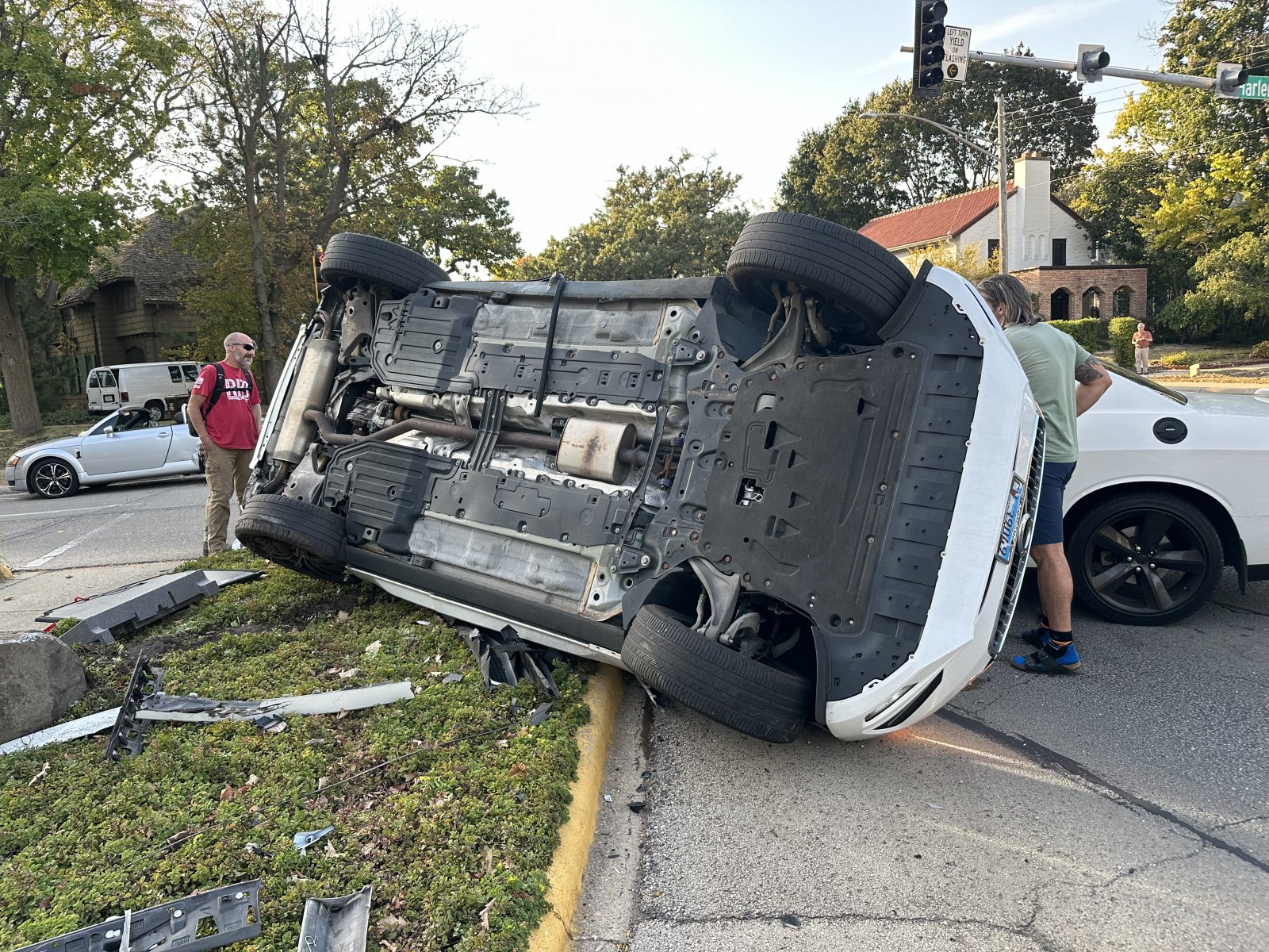

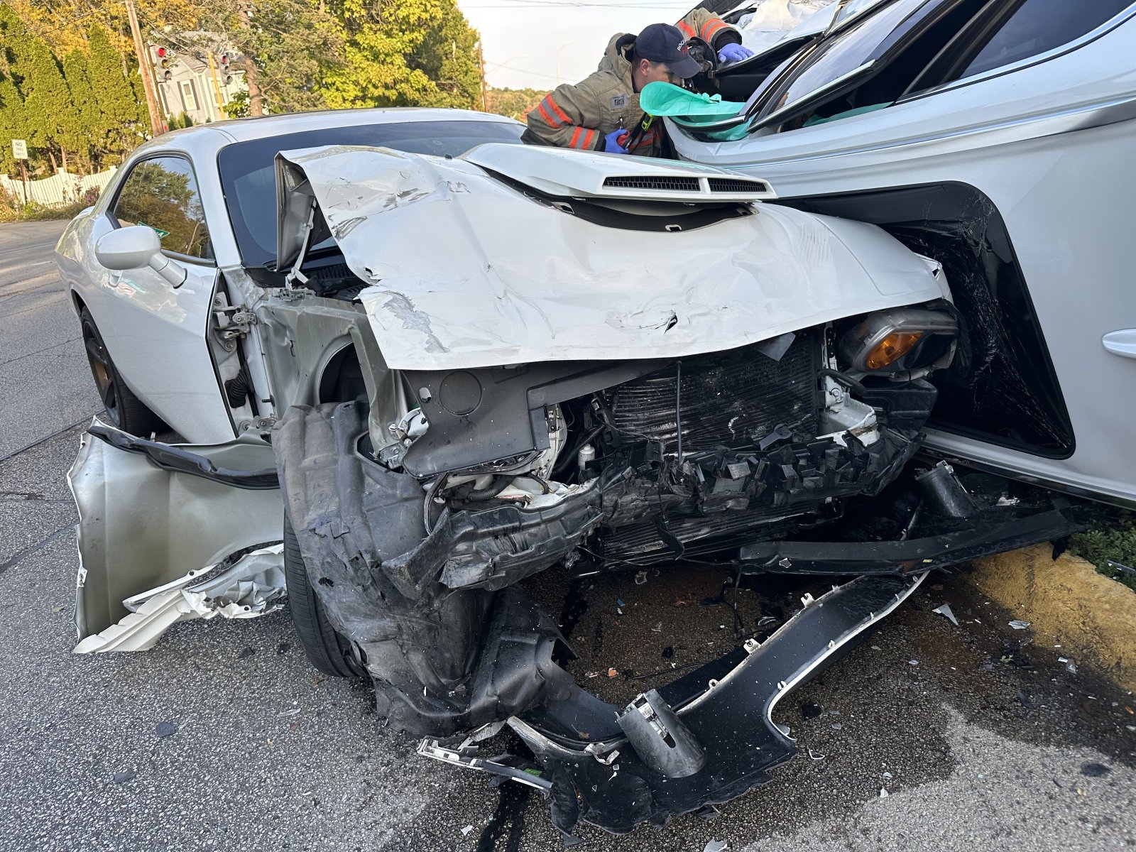

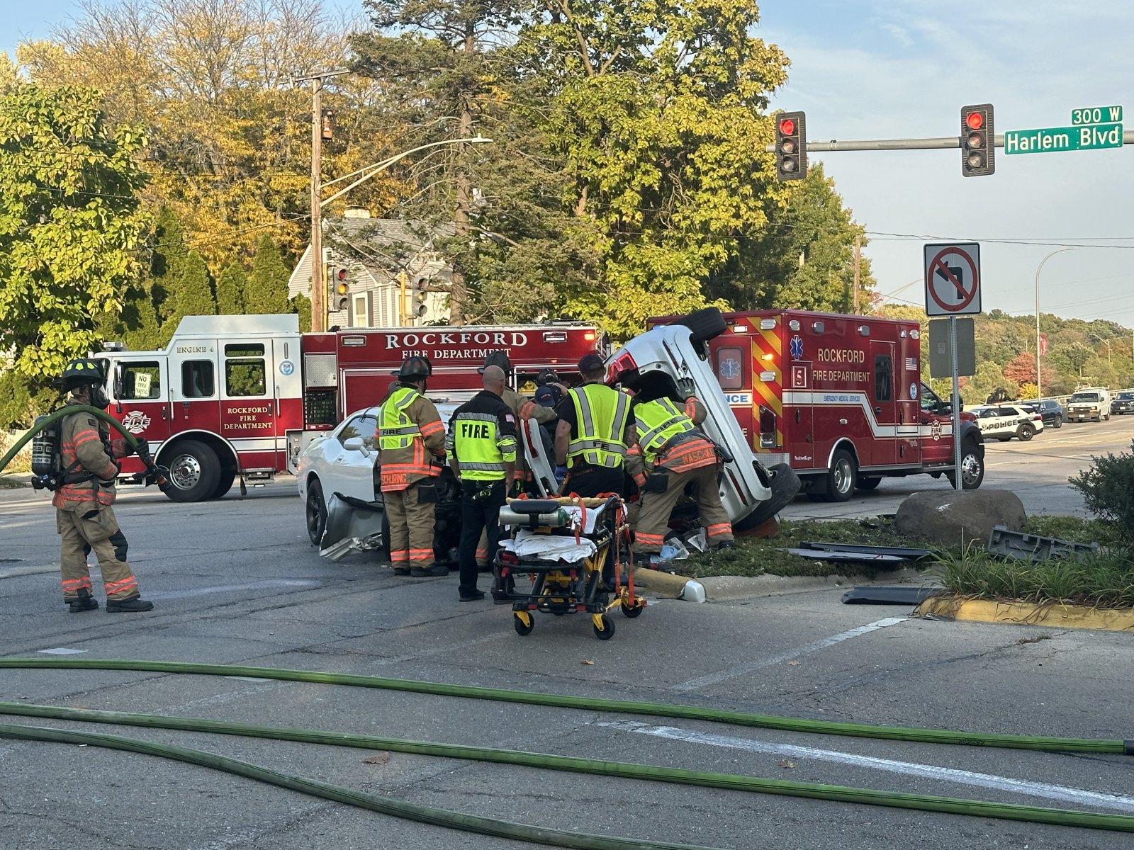

As I’m working on the Tahoe, I’m simultaneously driving like a dick in my Challenger, and this happened:
Hopefully wasn't your fault. Damn.
