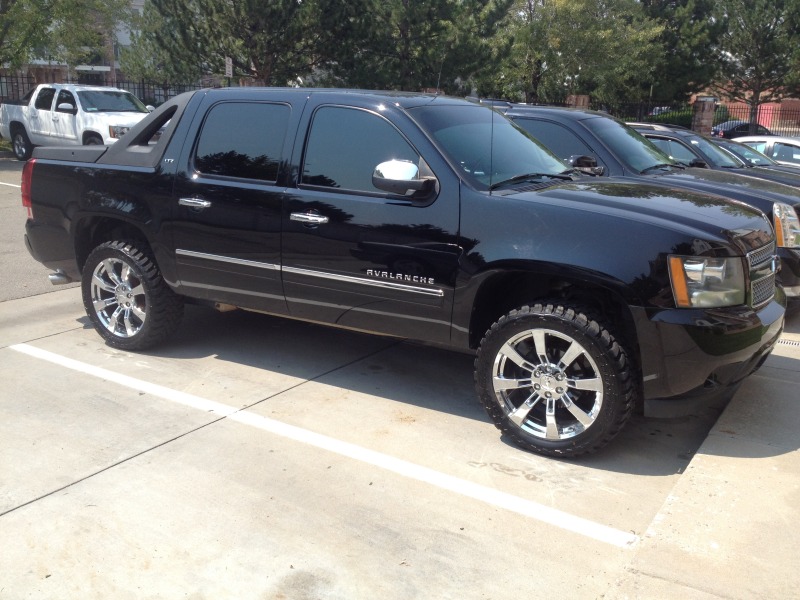

Do u have autoride? If so u can go 2.5/1.5 if u want it leveled. That's what my avalanche LTZ had:

Got it on eBay. No brand. They're all over the place on there cost me around $400 I think.
---------- Post added at 07:59 PM ---------- Previous post was at 07:58 PM ----------
Depends if your car has autoride or is z71 or 2wd. Different suspension will make it slightly different to make your car level.

I had toyo open country mud terrain 33x12.50R22 on a 22x9 rim
---------- Post added at 05:48 PM ---------- Previous post was at 05:40 PM ----------
Yes lots of rubbing on wheel well liner. That was with the 2.5/1.5 level I had on it.
