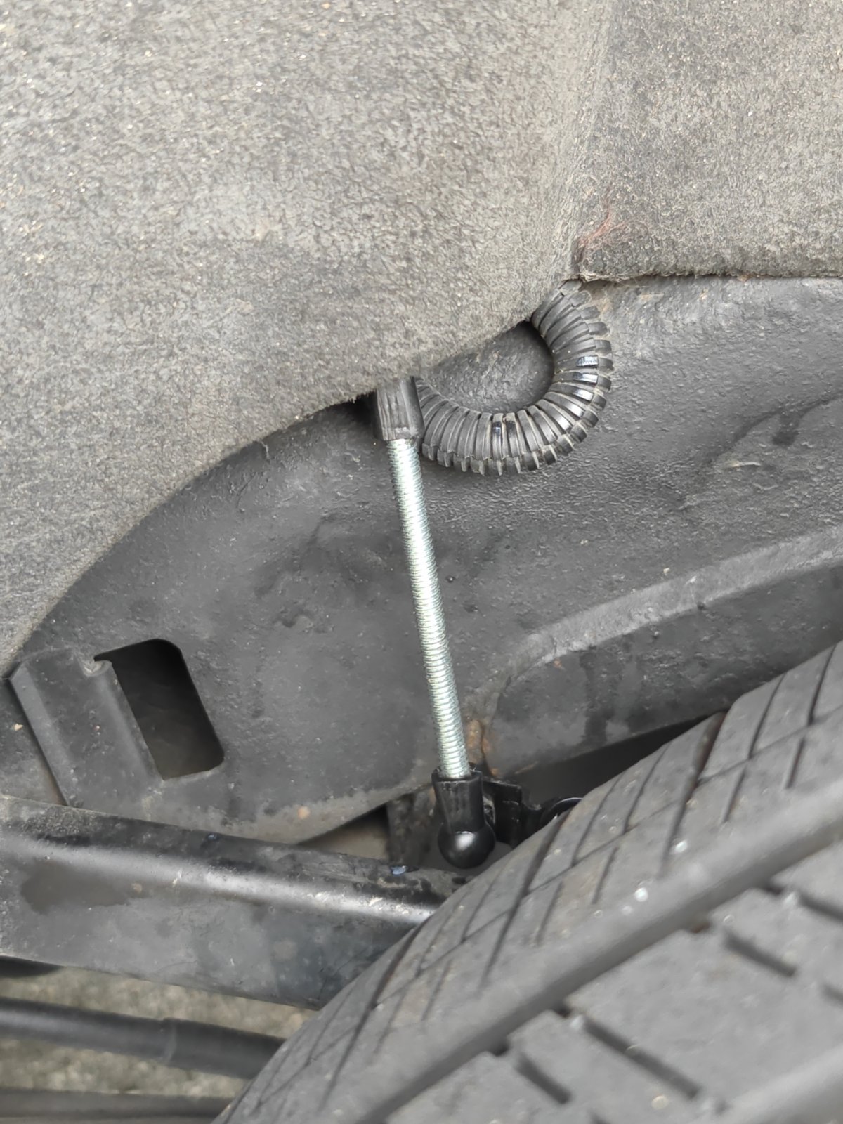

You should be able to get a 1/2” lift just by shortening the ride height sensor links by about 1/4”. That will trick the computer into thinking the truck has a bunch of weight on the back and it will add air to correct the squat. Be sure to check to be sure you’re still in the center-ish of the shock travel but it should be fine as long as you don’t go more than 1/2”.

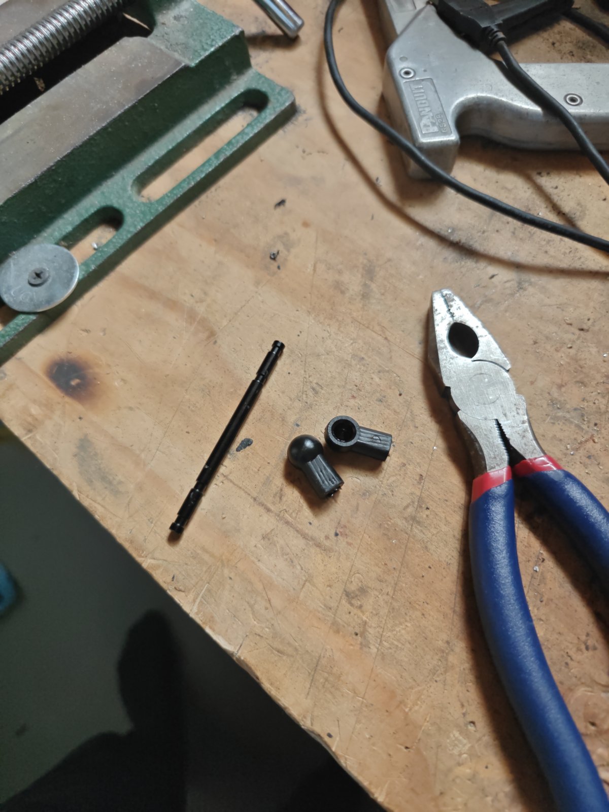

No, you shouldn’t notice anything. It doesn’t change damper rates afaik. It’s so easy to try, it’s ridiculous. Measure the old ones and make a set of shorter ones using a new set or there’s adjustable aftermarket ones available, here’s an Amazon link. They have plastic ball sockets on the ends, they just pop off and on. Dorman makes aftermarket ones that are stock replacements you could probably modify. Amazon https://a.co/d/2pXuUGN

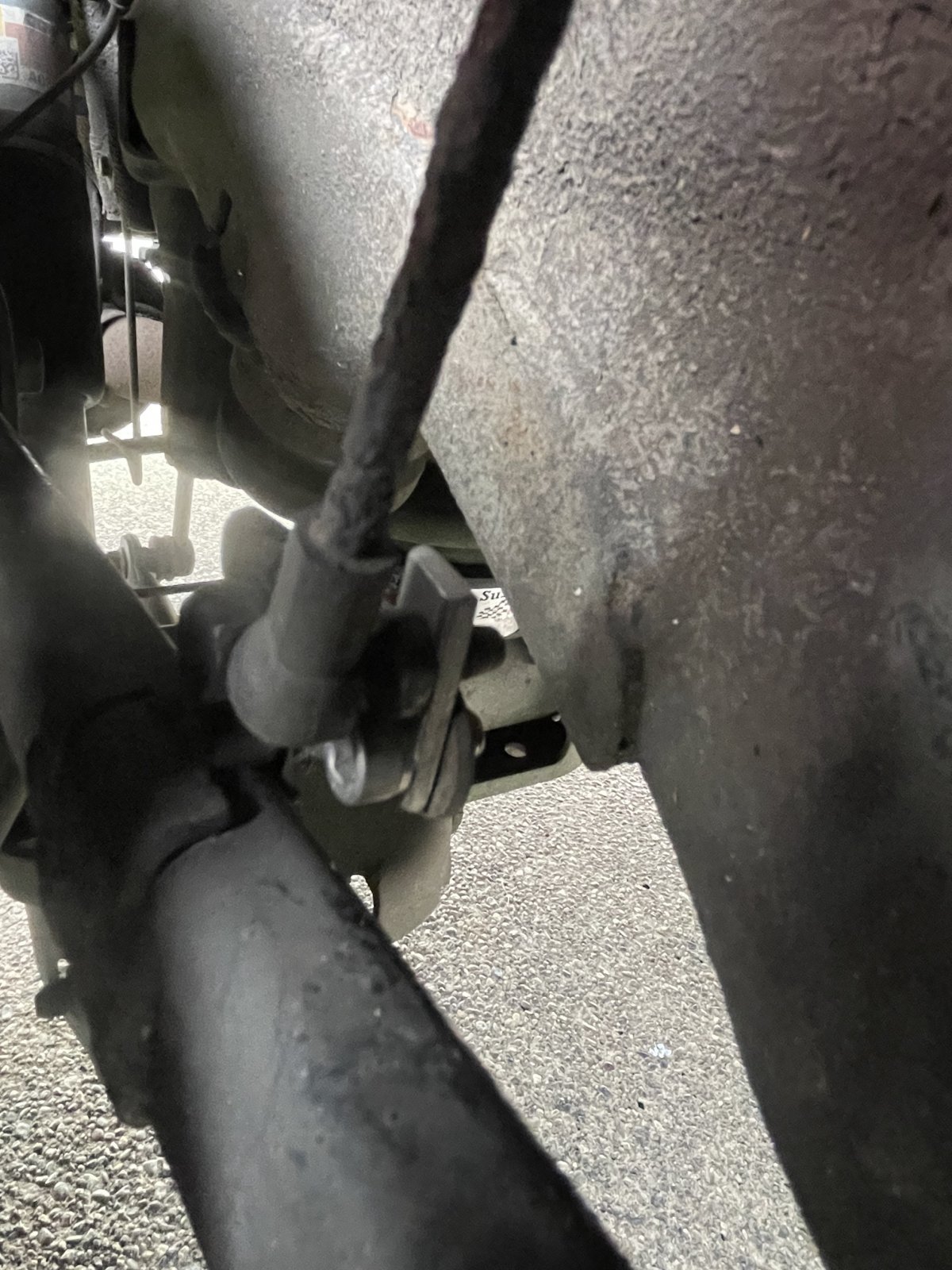

Like some suggested, you can get an all thread cut to length or the adjustable bar. When I did a baby lift on my 16 suburban, Maxx suspension sent a piece of metal bracket that moved the stock sensor bar up with shock extensions. Magnetic/autoride still functioning, rides like factory.
