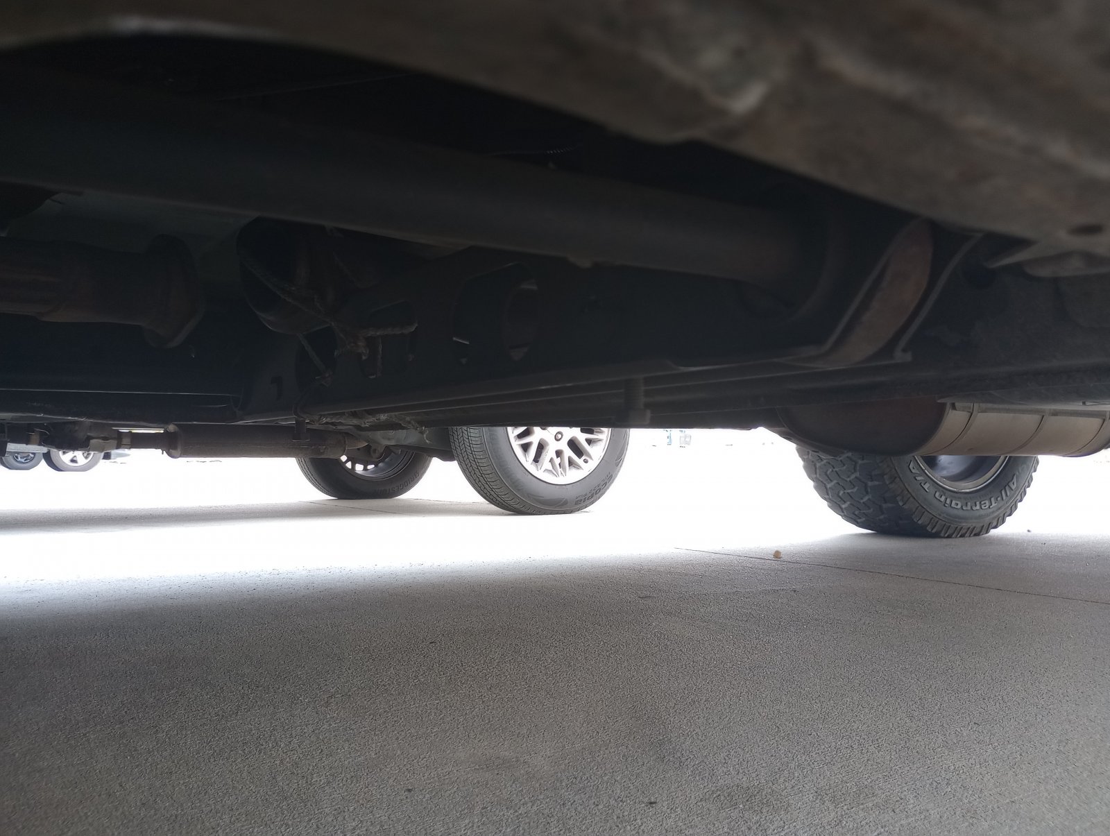

Did you purchase this truck new, or did you purchase it used? I'm asking, because from your 1 photo, it seems that your truck is sitting lower than I would expect to see from a stock height. Is it possible that it has been lowered?

I did purchase it used, she has around 224 k on her. And I believe that she was lowered. When I got her she was sitting on 265/50r20 now I got her on some 285/55r20. I agree knowledge is power, that is why I am trying to get all the info I can before I put money into her that don't need to be.

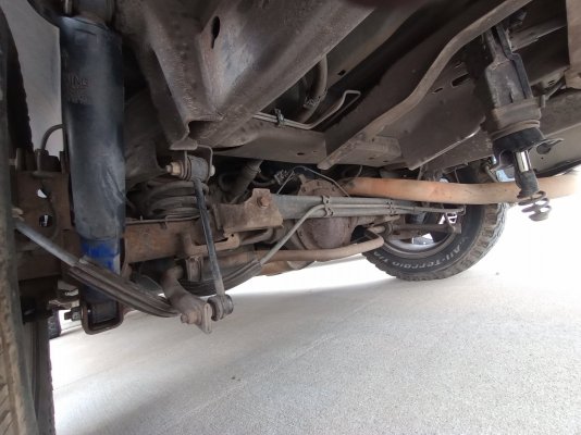

Now, I just noticed you said your truck had been lowered. It is going to be important to know how that lowering was achieved as well. If it was a drop spindle then you are going to gain 5-6" of height in the front instead of just 3". If the torsion keys were backed off, then you may just want to set them back to stock height, or "cranked" height for a bit more height than stock in the front. You will need a front end alignment after adjusting the height via torsion key adjustment.

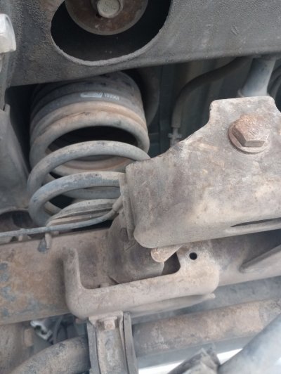

That also brings up a concern in the rear. If the rear was lowered, then the spring has either been cut, heated, or replaced. If that's the case then you are going to want to find a set of stock rear springs, which if you want taller than stock height you can also install the rear block at that time. If you do not install the block but just install stock height springs then you will want a stock rear shock. If you do a stock spring and a lift block, then the rear shock you have linked will work just fine.

There is an old saying that you first need to know where you are, before you can plot where you need to go.
I recommend that you thoroughly inspect your current suspension (since you believe that it was lowered) to know exactly what you currently have, as it will probably impact your choices to get where you want to go with it.

That is good advice, I'm going to get the front end done first, and count my rear springs and compare it to my buddies to see if how it was lowered, I'd rather not buy new springs if she don't need them
