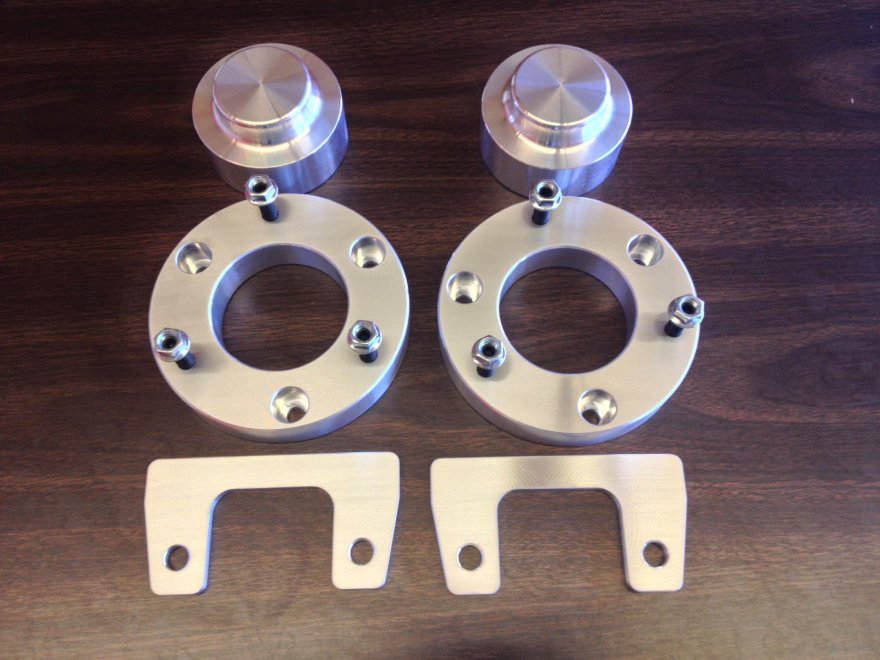

Here is a picture of the kit I received. As you can see, the rear is pretty thick. If you put the front lower coil over spacer and the upper spacer block together it is still about 1" less than the total thickness of the rear.
The front together is about 1.5" while the rear is about 2.5".
:hmmm2:
Edit: Ok I read up some more. The ratio of the front lift thickness (both spacers combined) will not be a 1:1 due to the lower A arm angle being changed. Still, I need some factory measurements. Something is still off. Thanks.

it has to do with the geometry of the front suspension, while the front kit doesn't stack up to measure 2.5" high the overall effect on the suspension should lift it that much ~roughly~.
typically what i have seen (with the NNBS) is a 2.5" front 1" rear will give u a lifted/leveled stance, where 2.5" front 1.5" rear will give u a lifted stance with some rake (usually still less rake than stock)
