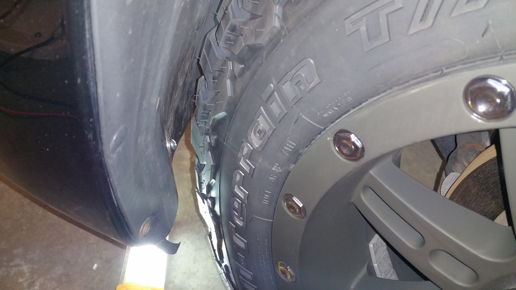

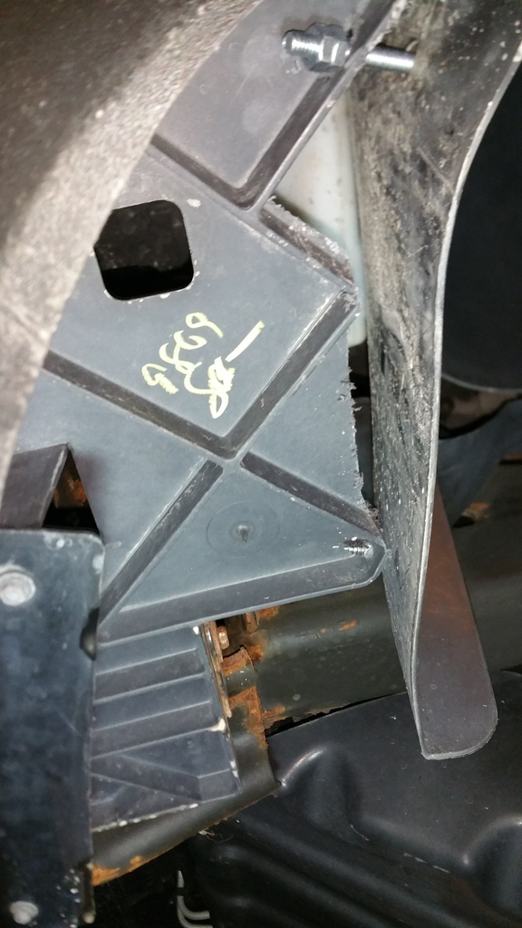

The kit is 2.25" front, 1.5" rear. Attached are the pictures of where it is rubbing on the front drivers side. The 5100s are set on the lowest setting, I did this because I was afraid of the front having too high of a stance with both the leveling kit and the adjustable shocks. I understand I should probably crank them all the way up to see if that will help, however, before I bring it into the shop I wanted to see if anyone with a similar setup has had a setup like this that didn't rub. If it's a lost cause then I'd rather not spend the money to have someone mess with the shocks, and just deal with the rubbing.

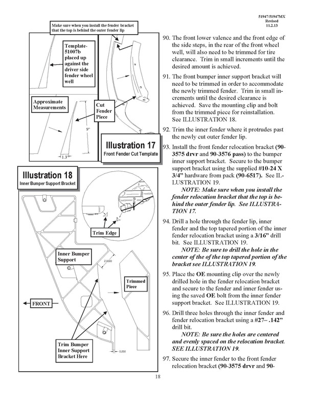

You can fix that trim yourself. Trim the inner front fender brace back like so the liner fits like mine. The rear side do a small nor cal mod as detailed in the link. No rubbing anymore once done.

Do you own a dremel or know a friend who has one? If so use the plastic cut off wheel on the front inner fender liner bracket then either use a L bracket retaining hole in liner or zip tie liner to bracket after cutting. The rear needs metal cut off wheel to make cut line then a hammer to bend it back away from tire. I'm not familiar with that area to cold for me haha. But I'm confident you can do it. I did mine in 10 minutes and no more rubbing the liner.

Dammit I love your confidence! I do have a dremel. The rear part of the wheel well looks easy. But I'll be honest, the diagram for the front confuses the hell out of me.

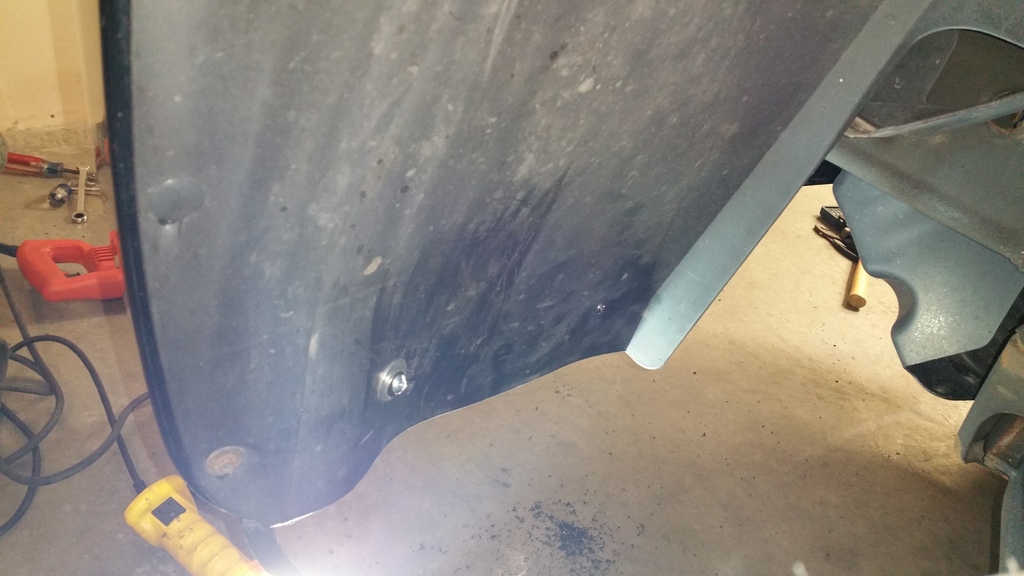

Good now get on it. Also ditch the lower valance bumper corner pieces on that z71 bumper. Looks much taller without them on and better overall. Here is a pic of the trimmed bracket looking up from the ground. Another member on here posted these pics so thank them. You basically use Image 17 from the instructions pic I posted with the exception of cutting the corner where it mounts to the painted bumper corner. Cut in along beside the angled support shown with large bolt through it then cut straight line down bracket until end. Screw it into the trimmed bracket and fender liner is now pulled forward.
