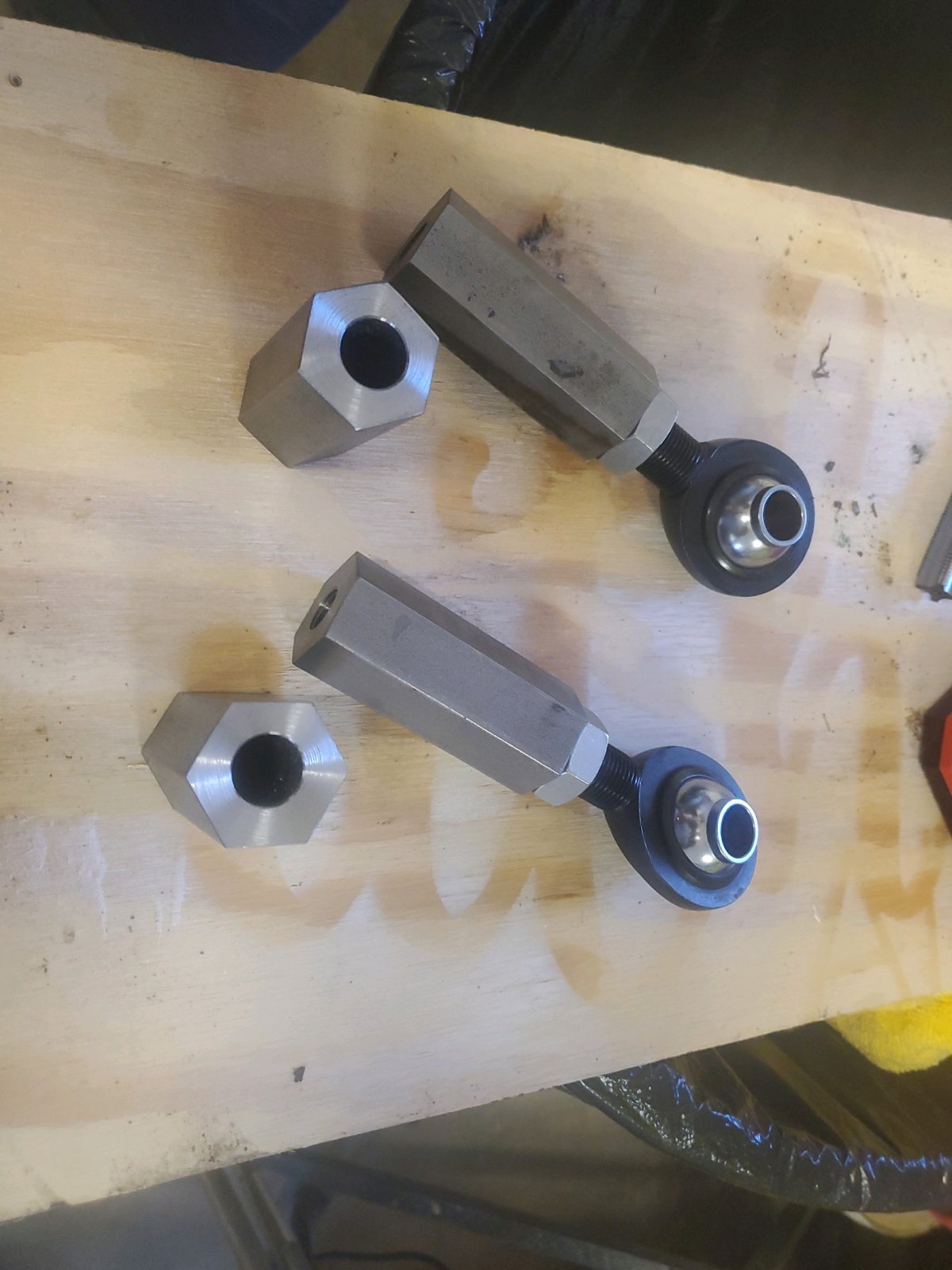

They are at slight different angles. The tie rod mounts to the top of the steering knuckle. So I can't flip it over to gain any height.
If I could buy or even made a spacer to raise the tie rod end up it would fix this issue. My fab skills are decent. But kind of a scary thing to build considering the tire will get ripped off if it fails.
So has anybody seen anything aftermarket like this?
