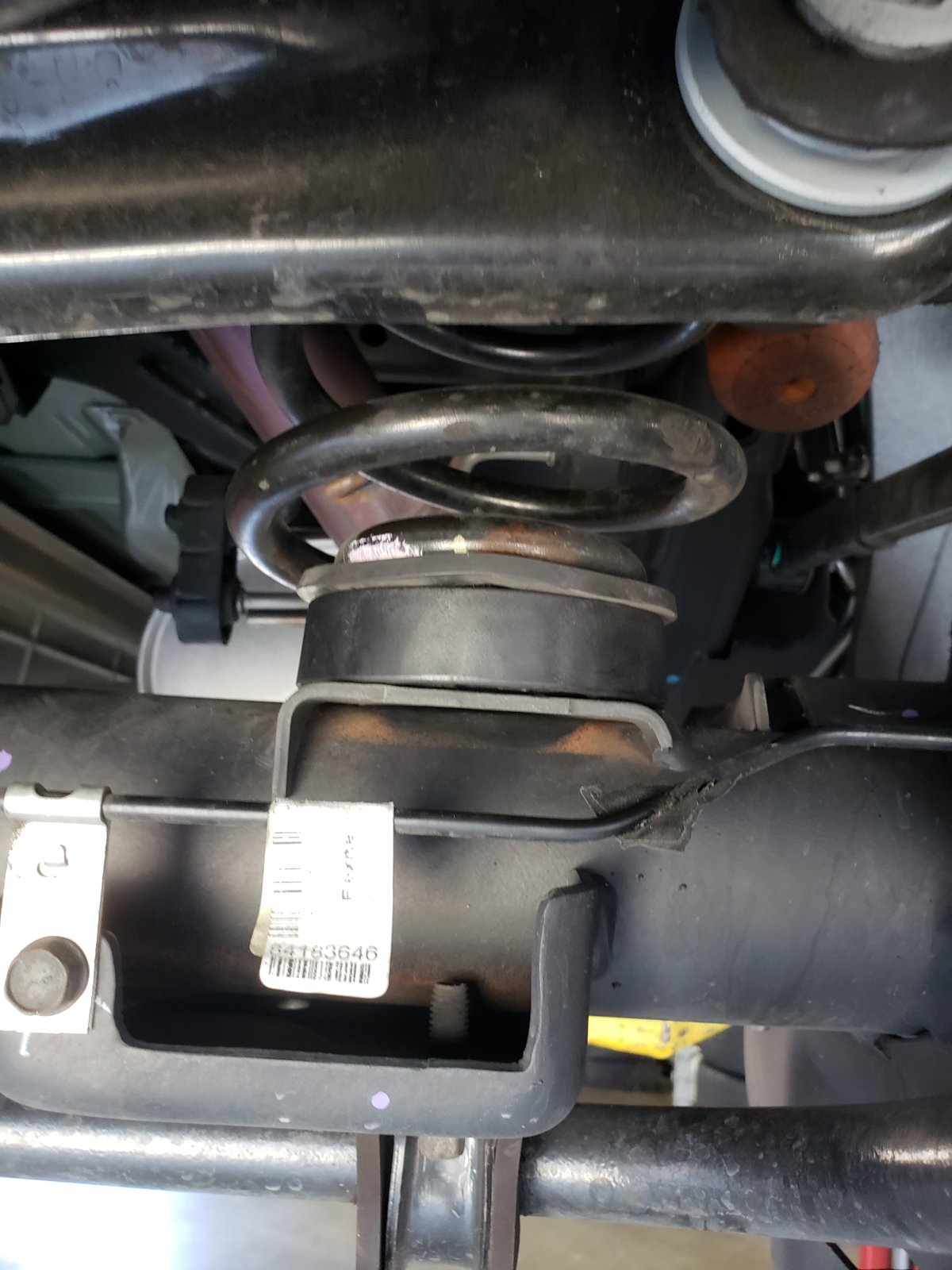

So I reached out to Tony who is on this site and is someone who specializes in suspension and he recommended to me to use a BellTech 1" spacer for the rear springs, part #35323, I ordered from Amazon for around $32 bucks and went this morning to install and just like the instructions from Belltech stated, the rear shocks need to be unbolted, and the rear suspension dropped and we pulled out the coils and the spacers fit right in the bottom of the rubber that holds the spring and put it back together, took maybe 30min total. Problem solved...the kompressor has not kicked back on at all...unfortunately having the front lifted where there was a rake in the rear it was causing the kompressor to turn on constantly to compensate. So far today after installing the spacers it sits more level and the ride is just fine.
Thank you very much to Tony Norcal SS for his guidance and professional advice, I would have gladly bought from him, but he recommended to just buy the part direct. Nice having people here to help! I appreciate the advice and hopefully this will be useful to others. Attached is a pic of the truck before, and then a pic of the spacer installed and then after.
