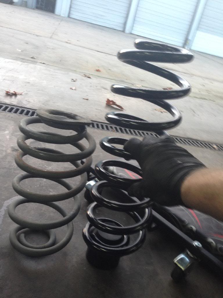

Thanks for liking my Yukon! I purchased generic lift keys from ebay and rear gold anodized 2" spacers also from ebay. Searched for specific year to fit the vehicle. I added the Z71 springs to equal the stiffness feel/ride from having the keys cranked. I think the Z71 springs are the same as the Denali/Escalade springs. I think the stock springs are around 15" tall and Z71 springs around 17.5" tall both measurements off the vehicle unloaded. You have to add longer shocks when you lift it because the stock bottom out of stroke.
Front - Bilstein 5100 Offroad Shock: F4-BE5-C153-H0 (Lifted Chevy shock)
Rear - Bilstein 5100 Offroad Shock: F4-BE5-6682-H8 (Dodge Ram shock)
