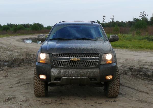

Looking to setup my truck to look like this Tahoe. Anyone have any suggestions on which lift kit to look into and what offset wheels?

YES!!!! another lifted NJ tahoe. Welcome to the club. It looks like a 6" lift. At that point its all down to personal preference. Fabtech and Procomp make good lifts.

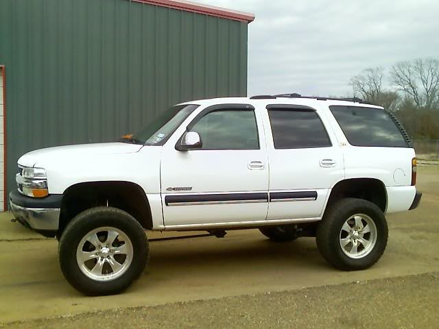

I just got done puttin my 6" RCX lift on it... i love it. i also have key's up front and a 1.5" spacer out back. This is my tahoe on 20's and 35's. These wheels have about a -12mm offset...
These wheels are just temp for right now. Im ordering new ones after my income taxes come in. lol

SloZ that looks damn good, i think you should keep those wheels and get different tires
---------- Post added at 08:16 PM ---------- Previous post was at 08:14 PM ----------
ahh now i want a bagged tahoe and i want a lifted one......frig
SloZ71Hoe
Jun 30, 2009
121
East Texas
haha, well i want a little more offset on the wheels... and the tires will get replaced after the wheels. Hell i got those tires for 300 bucks and they are 75% or so. lol
