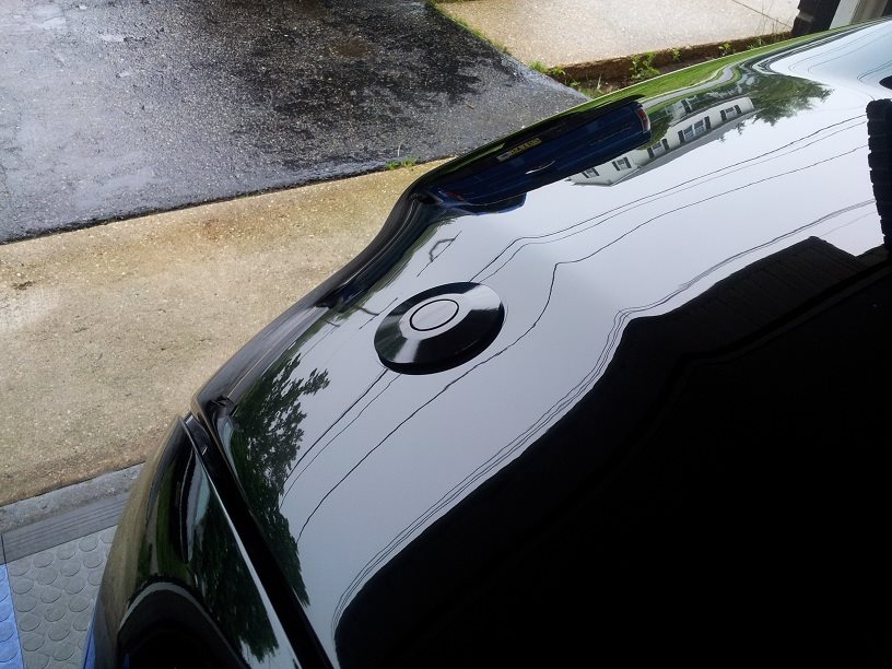

here is a low profile that I would get if I had to do hood pins. looks way better that those cheap dingle berries most people do from autozone
