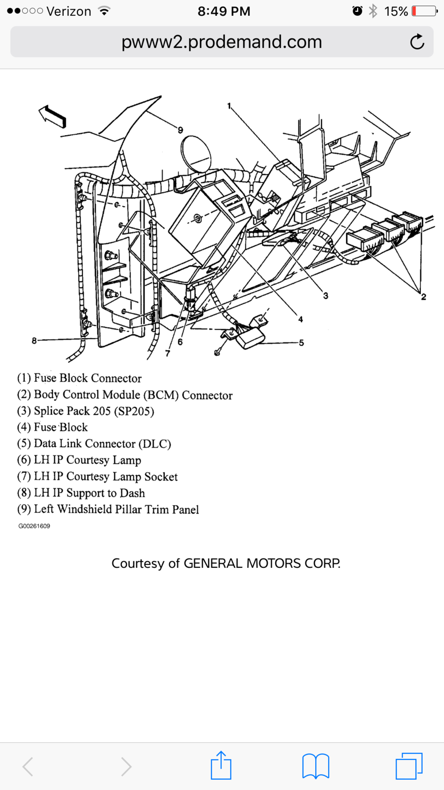

M1Gunner
Feb 7, 2015
1,078
1,236
Gainesville, Fl
Disconnect the splice pack sp205 (#3)and check the terminals for any corrosion and make sure it has a good tight connection.
