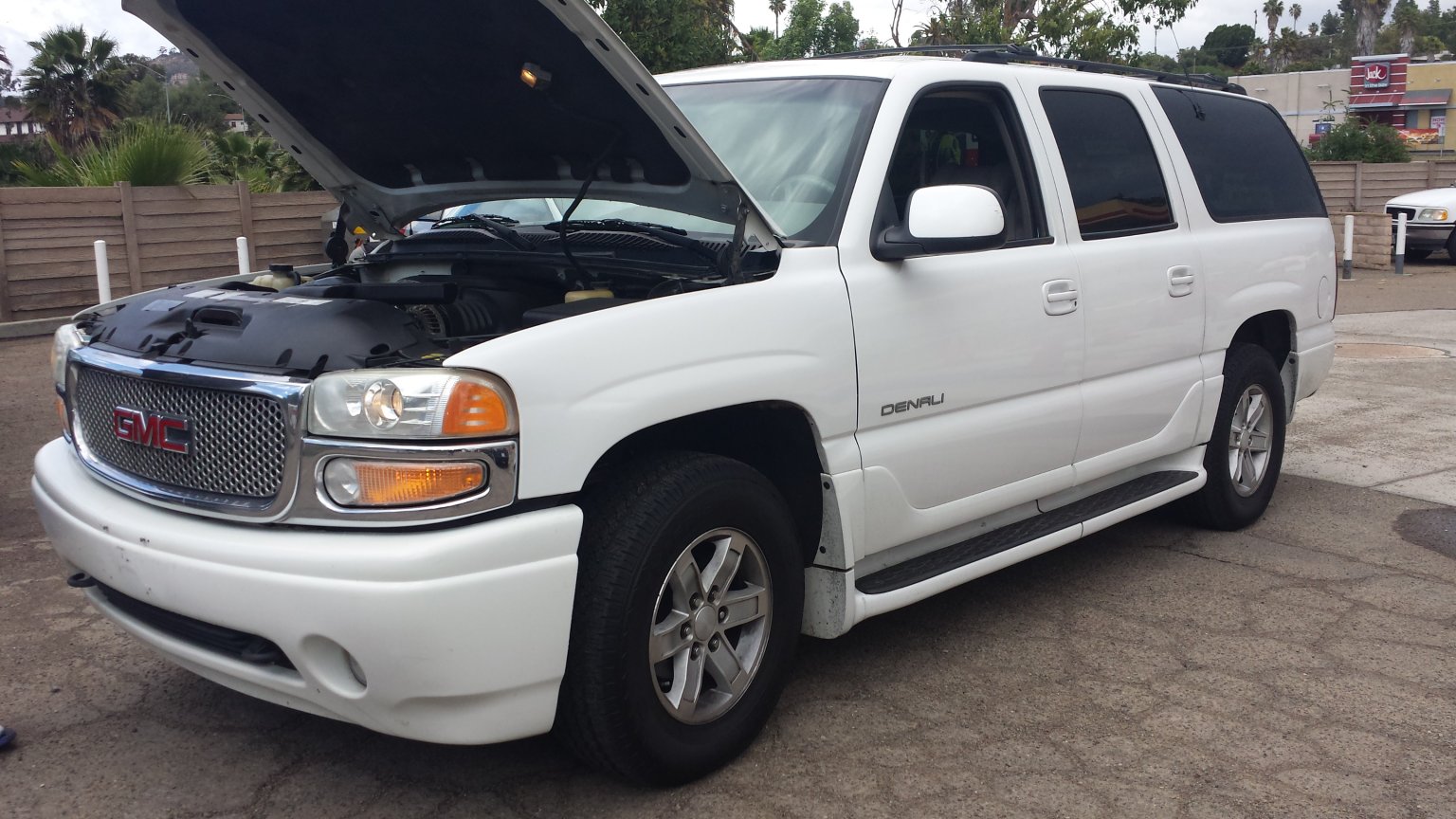

Just checked it out and wow, the 6.0 is a powerful beast. I def know I will no issues on the hills with Denali. The Exterior and Interior were immaculate. So good that I feel I am stealing it. I have to do this transaction with my bank so it's now in their hands. It's got some CL codes and seller said his mechanic said it was a bank 1 cat. Not a big deal if that is what it is. $160 cat and install myself. I brought my OBD reader with me and I still have the codes in the reader so I will research them out.
