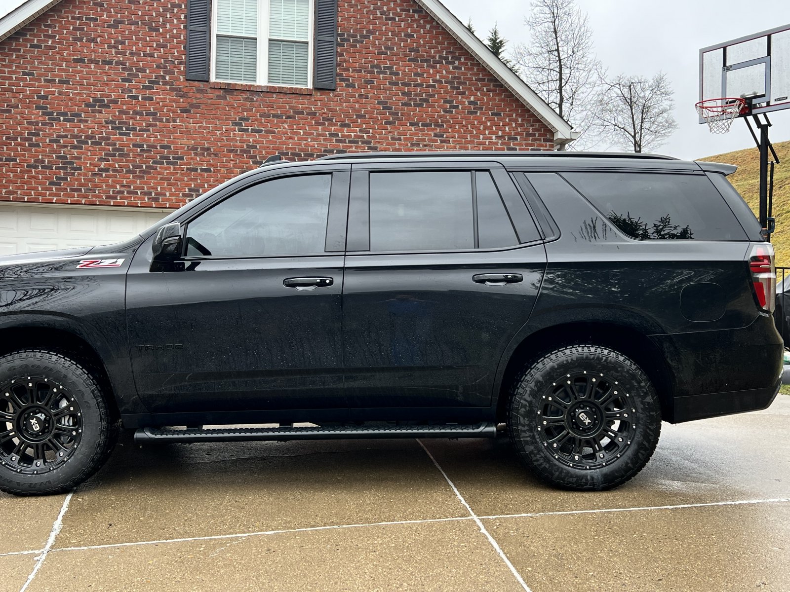

Highly unlikely that the stock wheels are forged on these.
Forged wheels are much more expensive and usually only found on higher-end performance cars or when an OEM sources from BBS or the like.
Most OEM wheels are cast.
The best bet for consumers is to try to look for a wheel with a forged barrel and cast face, sometimes called Flow Formed.
A forged 18" wheel (like in my profile photo) weighs 18lbs and for a car range from $800-1000 each - for an SUV even more.
I bought a set of 18x9 RPT1s for my 22 Yukon, they are flow formed. Enkei calls their Flow Formed manufacturing process Most Advanced Technology (M.A.T) and they were about $500'ish each and weigh 23lbs (2105 load rating). Mounted on a 275/70/18 Michelin Defender LTX MS each wheel weighs 75lbs versus the 20" factory wheels/tires for an SLT coming in at 81.4lbs. Most of this weight is tires (52lb each).
Look up the effects of unsprung weight on vehicle dynamics, saving 6.5 lbs a corner is nice, even for a heavy SUV. Doing the opposite is a no bueno. Combined with a low rolling resistance tire I expect to pick up a couple of MPG overall.
I'm going to do a thread on everything I've done with the truck once it's done.
