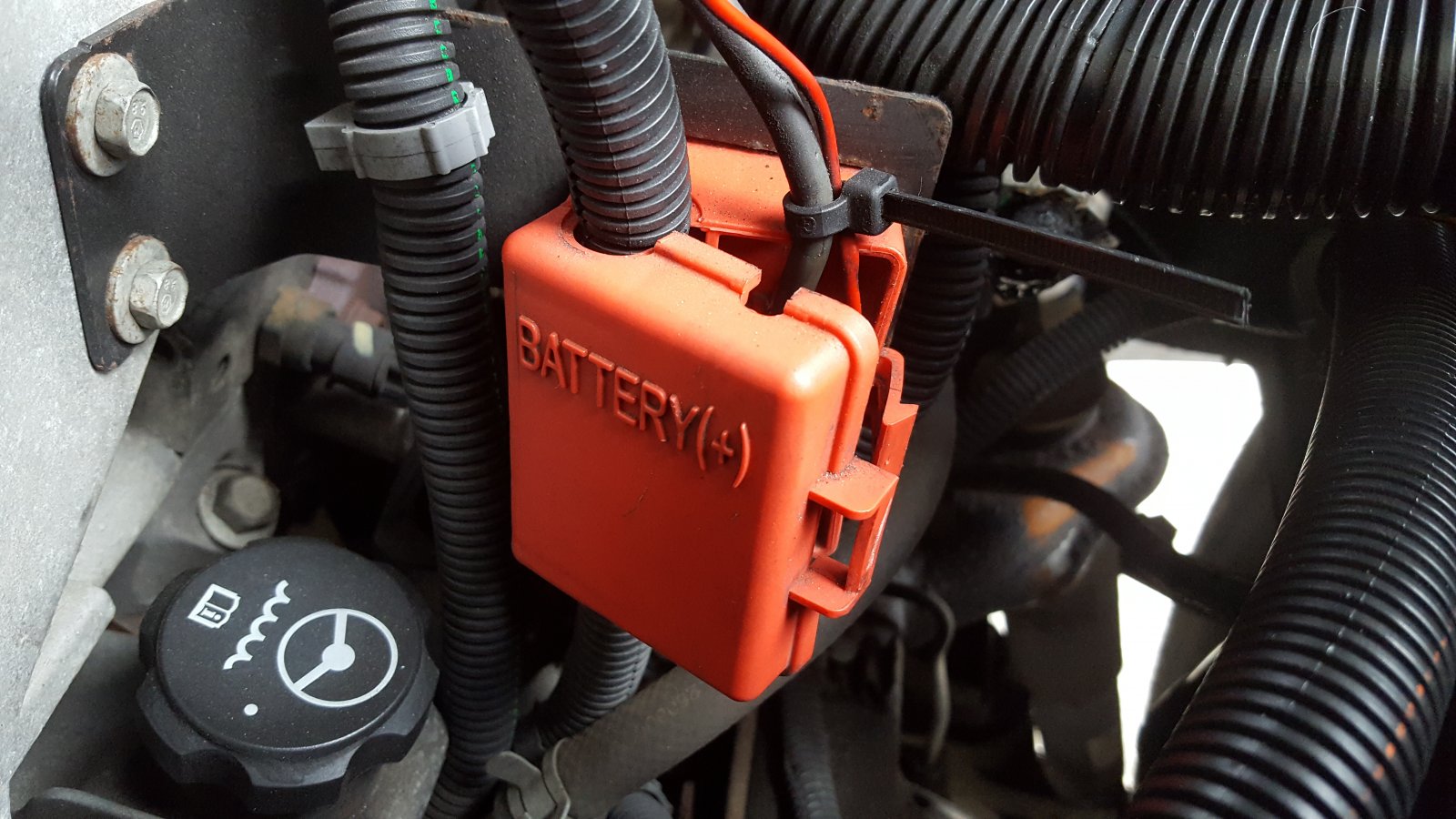

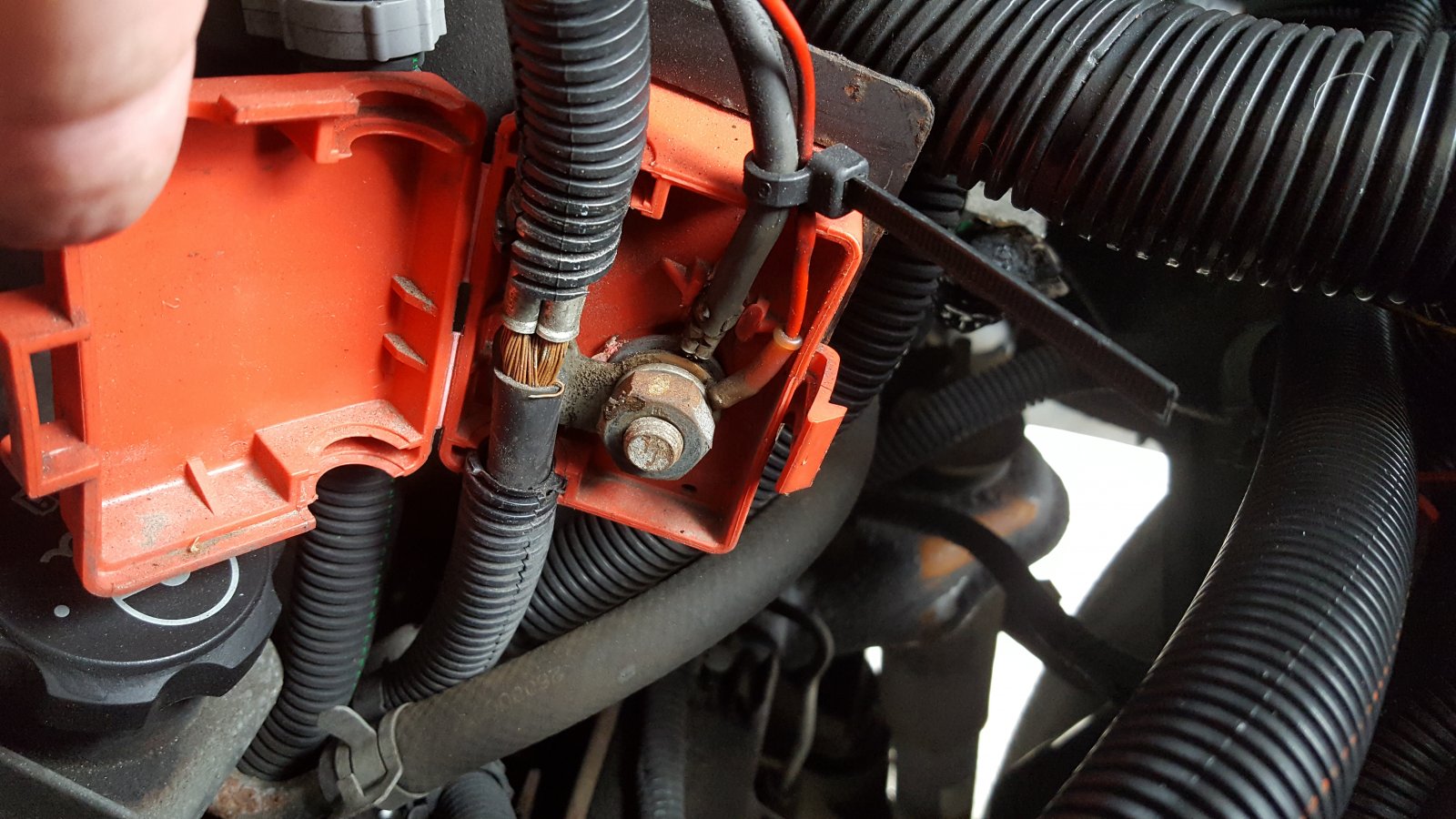

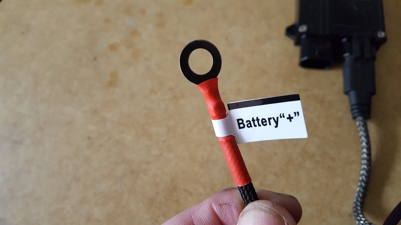

I received my TRS, 880 Morimoto Elite - Fog light kit yesterday. I am looking under my 2005 Yukon to see where the harness will mount. Not sure yet where the "OEM Input" end goes, and where the one single pigtail goes..... It's a neat harness kit..... Still learning....
