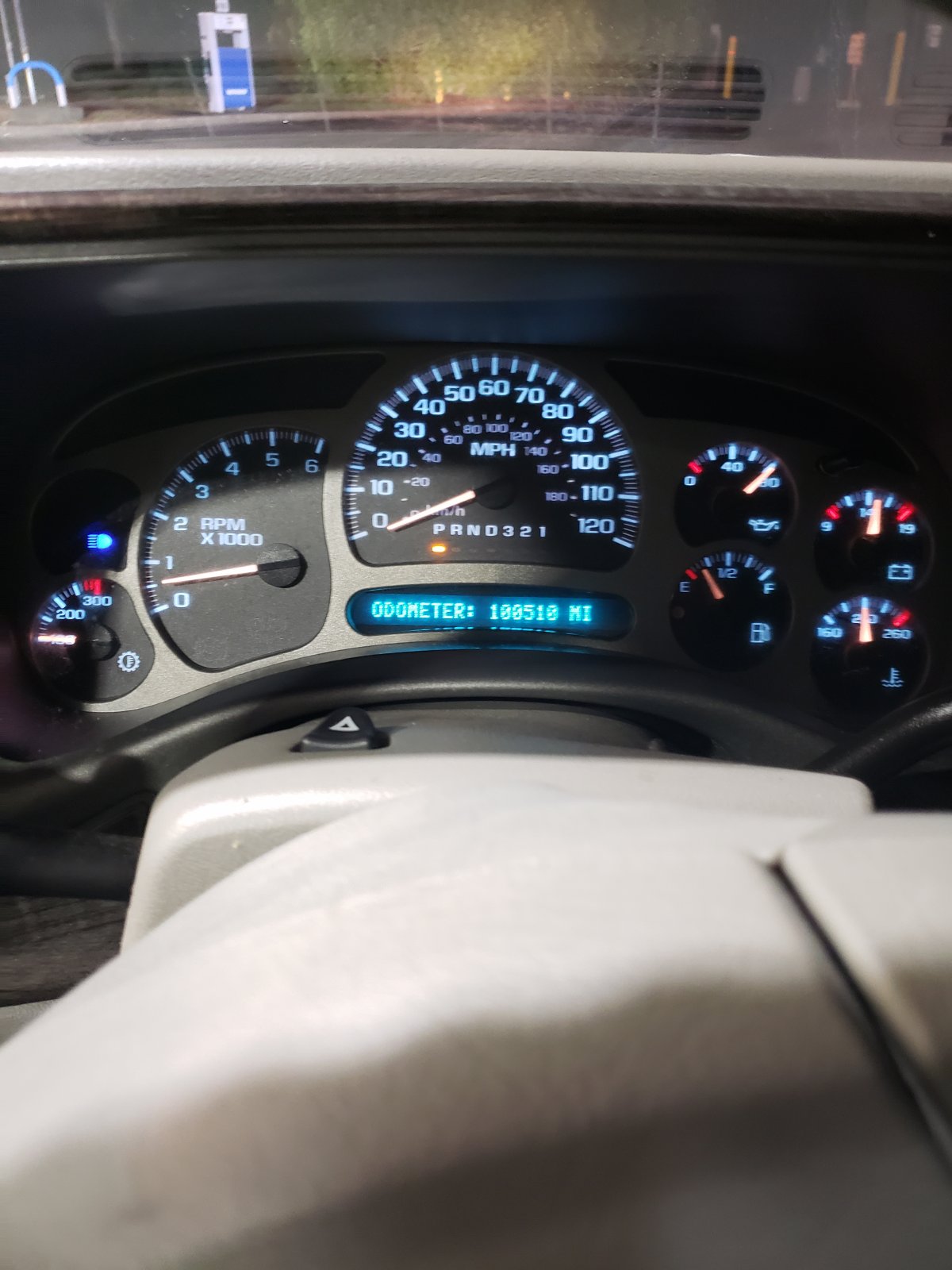

- Oil pressure gauge was at 80

IMO, NNBS and NBS are really close but the NBS is overall a more reliable vehicle. If you like the styling more, then save your cash and get the older and cheaper one. This will leave plenty of funds to fix the small things. I figured you were up north by the prices you listed. Those same examples in my area would be $1,000-$2,000 less. Even still, I think $8,000 is a bit on the high end, all things considered. I agree with Jeff- offer a thrifty but fair minimum and have them talk you up rather than you talk them down. They may not even be the haggling type and may accept or counter relatively little from your offer. The key is knowing what you're looking at so your offer is fair and valid. As for the issues, they're all easy fixes. The pegged oil pressure could be a faulty stepper motor in the cluster or a failed sensor- both common and easy fixes. Headlights could be a relay, fuse(s), loose ground or (hopefully not) an issue with the BCM or multifunction switch. Having only 4 speeds, each gear typically has to be held longer. Your description of the shifting neither confirms or denies a fault. What's more important is HOW it's shifting when it does shift.
