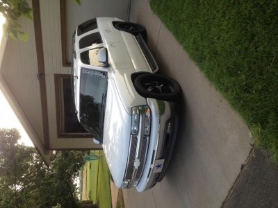

I have a 2004 Tahoe on 24s with a 3/5 mcguaphys drop kit on it. The kit gave me about 4in. of drop in the front but only a little less the 5in. in the back. I love how the front of my Tahoe sits but I would like to get about 1-2 more inches of drop for the rear to get rid of the rake that I have. Any suggestions on how to do that whether it be doing some cutting or going out and buy something more to install?

Have you done the free travel mod? If so, Tony sells a 6" drop rear spring that might work. Belltech also sells a 5305 rear spring that can be trimmed to get the perfect stance by cutting out the dead coils a little at a time. I run those Belltech springs and like them alot.

I will have to look up those 6" coils sounds like they would be what I needed. Thanks for your help

The 6" drop spring is great and rides great. I would look into tonys spring to go a little lower. I have helper bags in mine because I'm always fillin up my truck with things and nieces and nephews.
