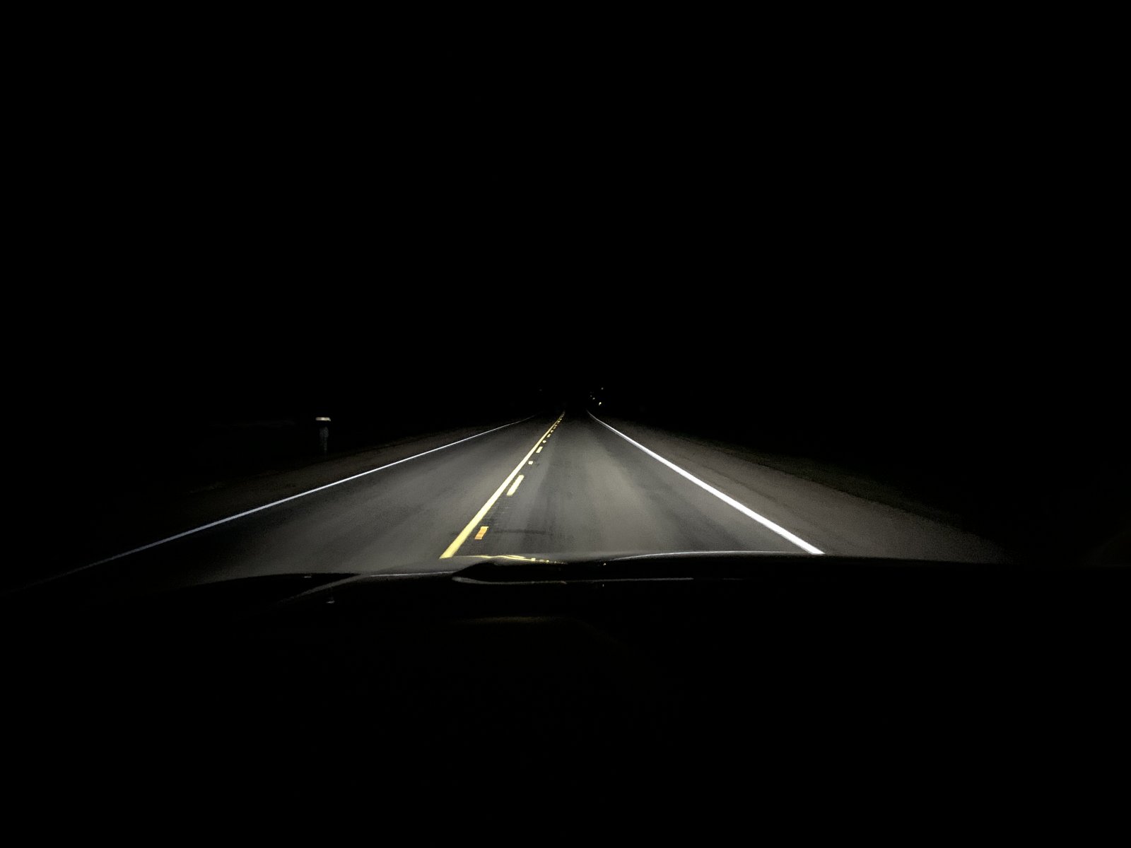

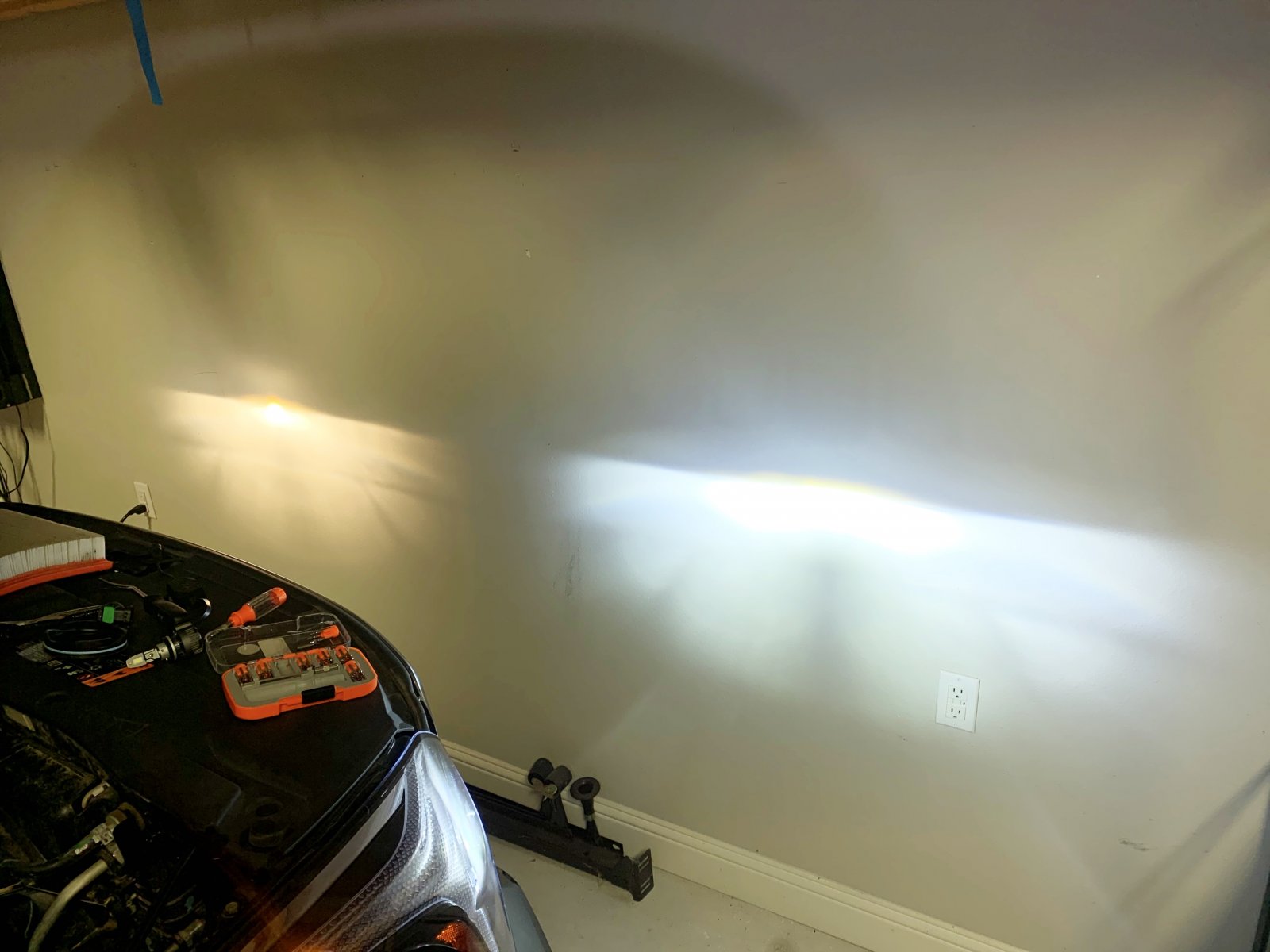

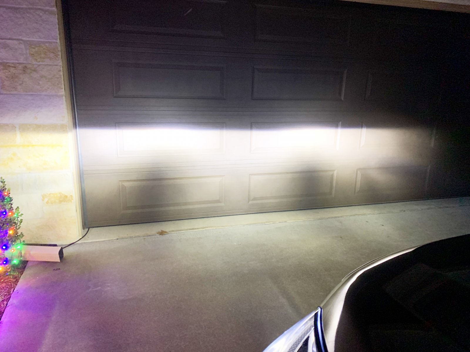

New to me 2019 Yukon XL SLT with halogen projectors was in desperate need of upgrades to the halogen low beams. Researched some different options and these DDM Tuning LEDs had a good following. I avoided any LEDs that had marketing spelled in broken English lol. Just didn’t feel right paying under $50 for LEDs on Amazon straight out of China.
These blades are adjustable 360° and they did require fine adjustment as I wanted to get them just right. I didn’t like the little Phillips screwdriver they provide as I almost stripped it out, but fortunately I had a micro Phillips head kit that made it easy.B282393C-495E-4392-99CA-F519D8156042.jpegA2664847-F60D-4DA6-8A9E-8AC6DE473C0E.jpeg3A9A7A80-5018-4E02-BBD8-03B09C6A63FF.jpeg

What adjustment did you have to make? I was under the impression that the only reason you would have to adjust these was if the bulb mount in the headlight was canted. Is the Yukon not a straight mount?

After putting the bulb in the housing and twisting into position the blade was not vertical…it was probably 5° off vertical. So I had to loosen and adjust the blade. They’re the 6000k.
