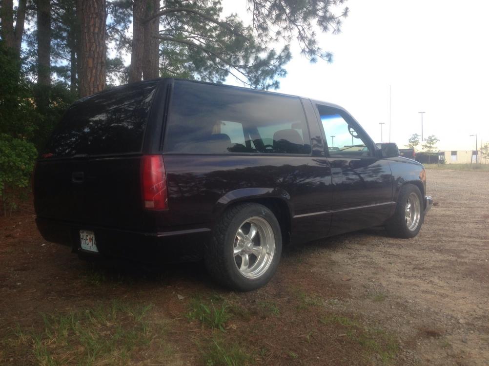

Mine is 5/5 but the spindles on here cause bump steer but it rides pretty good. I want to get shock extenders and 1 in hangers to go down in the rear a bit more
255/50/17 all the way around
