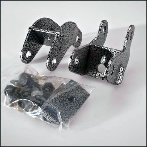

I also purchased and installed the rear DJM relocating sway bar end links.
I probably didn't HAVE to do the rear free travel mod, but it seemed easy enough while we did the install anyway and I'm partial to doing things right and being "over preventative". So the piece of mind knowing I was adding additional rear travel clearance rather it was needed or not vs. finding out later I should have done it while we had the rear suspension off and in pieces anyway was worth it.
