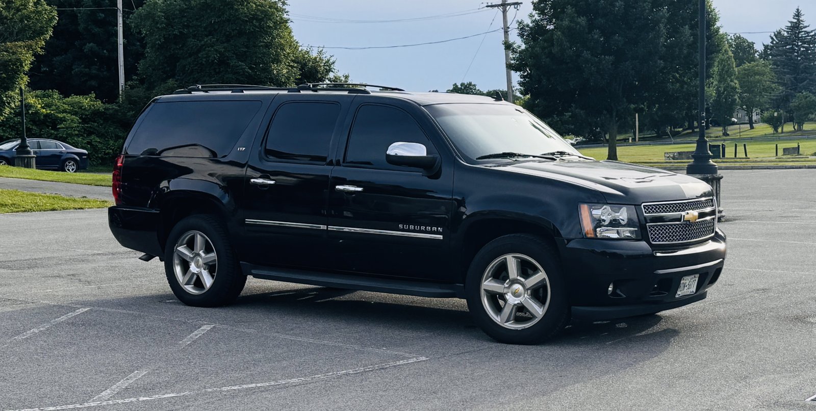

This is her truck by the way. I just pray it stays looking like this. Sadly it went through 2 Western NY winters, and in the country where the roads are terrible. We did get it oil coated (in the frame, in the panels etc.) both falls before both winters. And I will again before it leaves for good measure. And anytime it comes up here in winter, it will get oiled. But I am going to be so frustrated if it rusts. These dont hold up to salt. I own an online car dealership so I can always get another one but this one is her baby and I know how it's been cared for.
