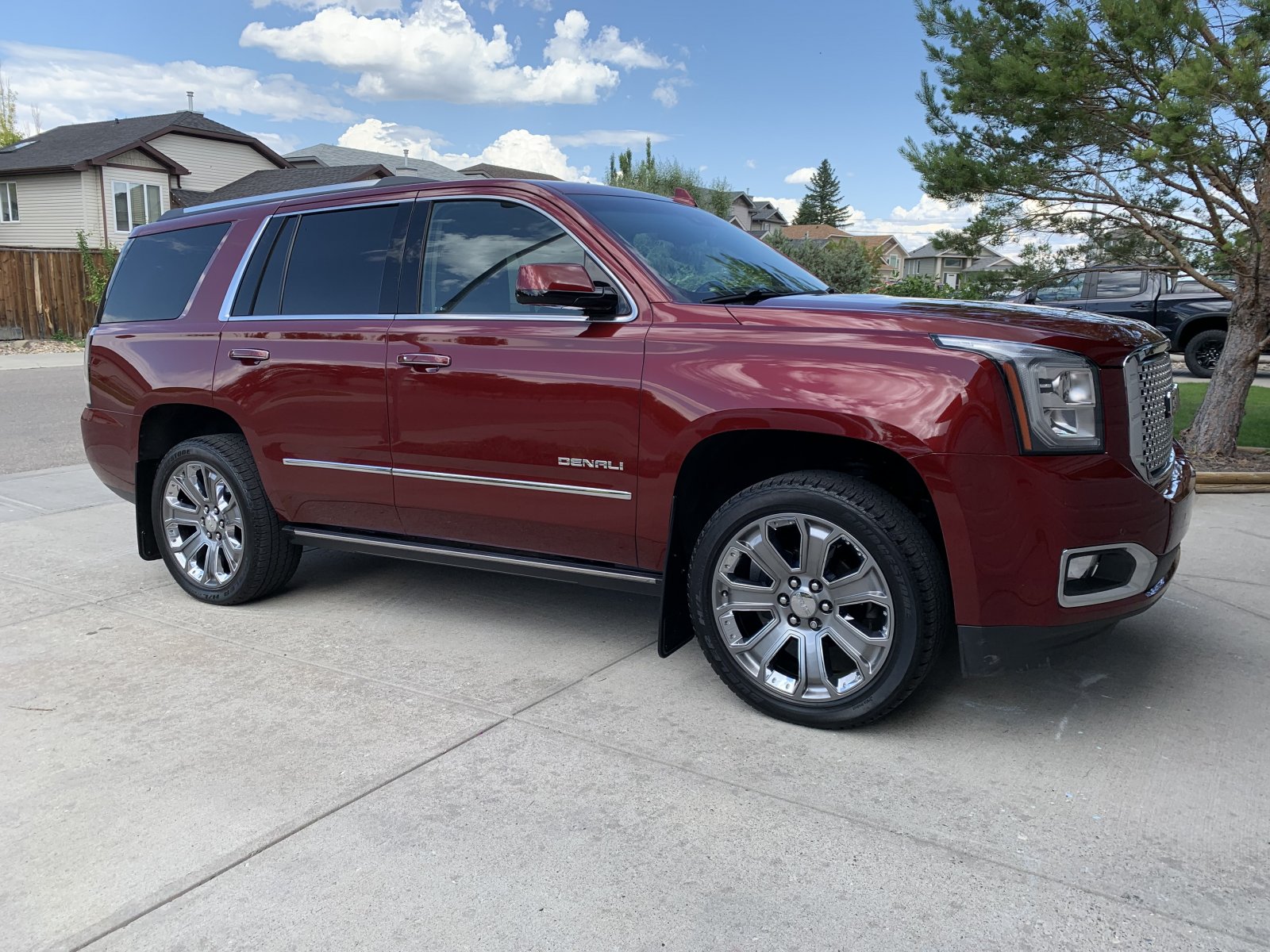

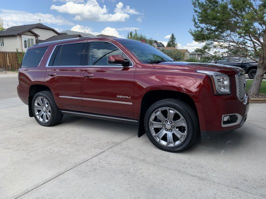

Hello gang, I just joined this very informative group. I am on the fence of deleting or keeping the mag aride on my 2016 Yukon Denali. All four corners are leaking oil and has started to ride rough. I’m on the fence to upgrade to Arnott or dele it with manga delete or strut masters. What are y’all doing with your failing magnaride suspensions? Thank you in advance
