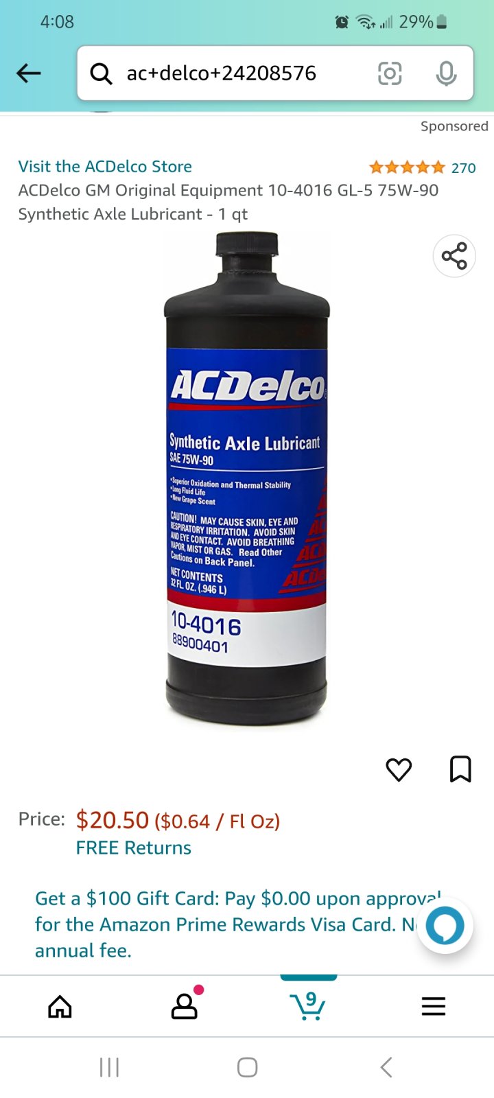

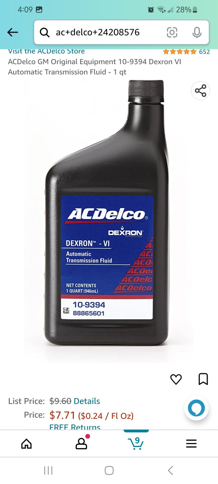

Hello everyone, new here. Well sorta. I had an account before for my 03 XL that I sold years ago. I recently picked up an 07 xl denali with 86k miles.
I want to swap all the fluids out. I'm finding mixed opinions on what to use. I'd like to stay with gm fluids.
For the front and rear diffs I'm reading I need synthetic axle lubricant. (10-4016)
For the transmission dexron vi (10-9394)
Now for the confusion, transfer case fluid do i use the same dexron vi ATF?
For transmission filter i have no idea which part # I need. I have the deep pan.
Pls guide me to the correct information and which part #s are correct. Thank you everyone.

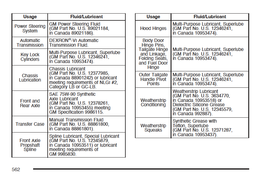

Welcome back! The owners manual for my 2007 Yukon XL Denali specifies GM 88861800, which is manual transmission fluid for the transfer case.
For the transmission filter, this should be the one you need: https://www.rockauto.com/en/moreinfo.php?pk=994080&cc=1433415&pt=8600&jsn=489&jsn=489&jsn=489

Thanks for the reply. The manual trans fluid is what's confusing me. I'm reading in places it's been replaced with dex vi and that's what should be used for the transfer case.

I found my manual it also shows the manual transmission fluid. I ordered that for the transfer case, the dex vi for the trans, and the synthetic axle lube for the diffs. I ordered that trans filter as well as per rock auto shows it fits.
Should I buy a new gasket for the rear diff cover?

I wouldn't overthink the fluids too much. Use GM stuff if it makes you feel better. Otherwise good name brand dextron6 (trans and t-case), 5w-30 synthetic for the motor, and synthetic 75w-90 for the diffs. I think the manual calls for regular 80w-90 for the front diff, but a good synthetic will work as well. I'm not sure if the manual trans fluid is any different than dextron6, but I'd like to know if there is a difference.......always up for learning new stuff.
Also to note on the front diff, you want to change it warm and it will probably come our with a metallic glisten to it. IT'S NORMAL on these, along with some fur on the magnet. You may want to change it twice in close succession depending on how it looks, but with 86k I can't imagine it would be too bad.

I ordered what ever oils show up in the owner manual. For the front and rear diff shows a 75w90 synthetic axle lube. T case shows the manual transmission fluid. Already did an oil change and changed air filter and added a cabin air filter.
I've never done fluid changes on diffs or trans but I'll be giving it a try. The diffs and t case seem easy enough. I'll have to decide If I'll bring it to a shop for the trans fluid change although I'd prefer to do it myself.
