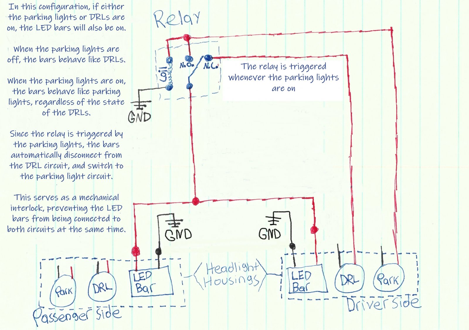

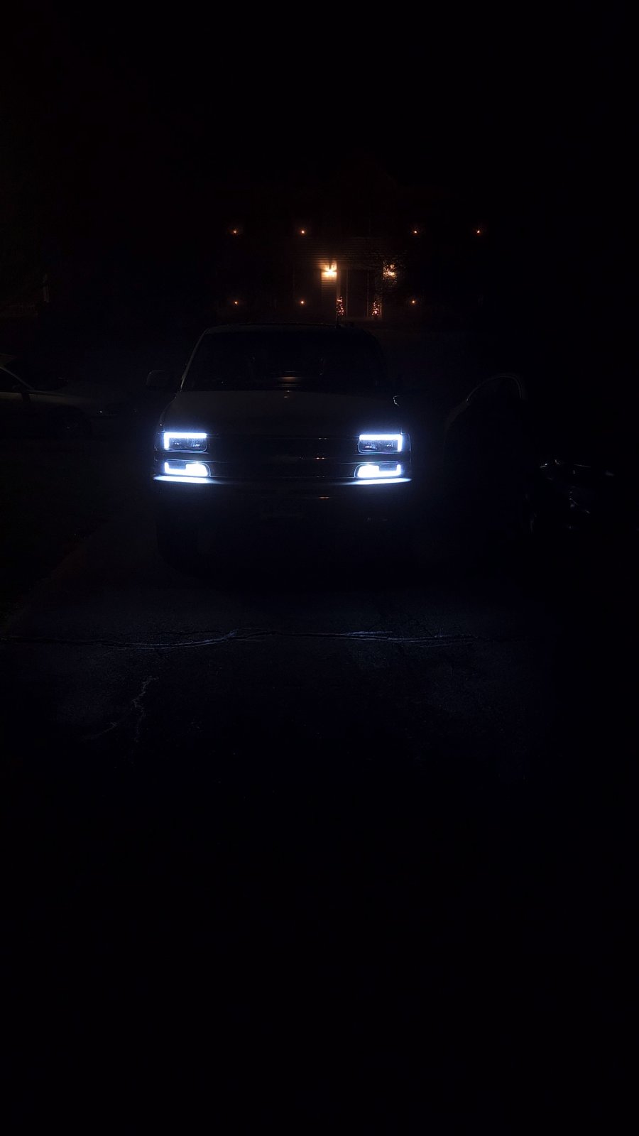

UPDATE: I finally got around to installing the new headlight housings over the holiday weekend, and I gotta say, I'm thoroughly impressed with both the look and light output/beam pattern at night. I kinda rushed the installation and ended up using the tap splice connectors that came in the box (yes those dreadful things). It's only temporary until I complete the rest of the wiring. As of now, the LED bars are wired into the DRL circuit so they only come on during the day or when I unlock the doors with the keyfob. I still need to integrate the parking light circuit so they'll come on at night too. I decided to use a 5-pin relay instead of diodes like I originally planned. I'll attach a drawing of what I'm thinking, and a few pics of what they look like on the truck. I'll post another update when its all finished.
