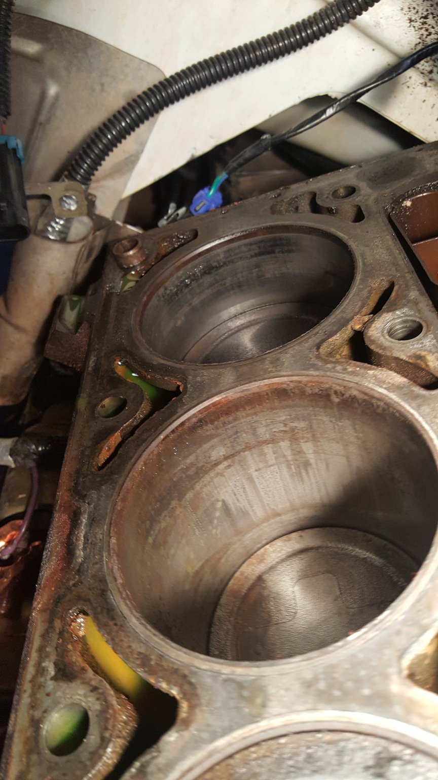

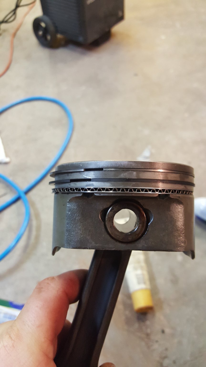

It's time to Salute the fallen, that made this entire swap possible
Time to go to the scrapyard Rollie, may you be recycled and turned into a prius or some shit...
That's about all the progress at the moment. the bad engine is bare and unbolted, but I have to get the remains of rollie out of the way before I can get it pulled out.
