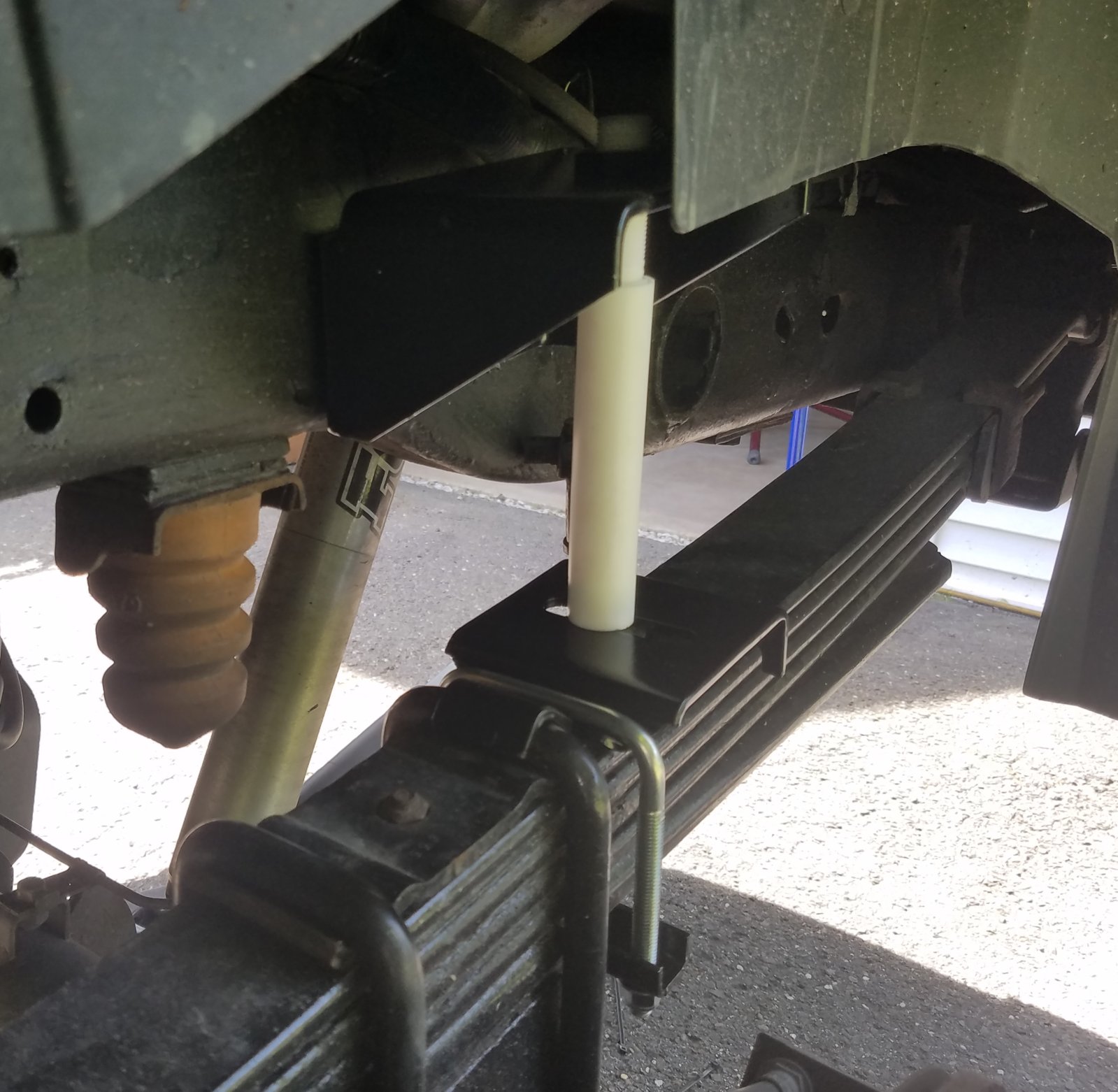

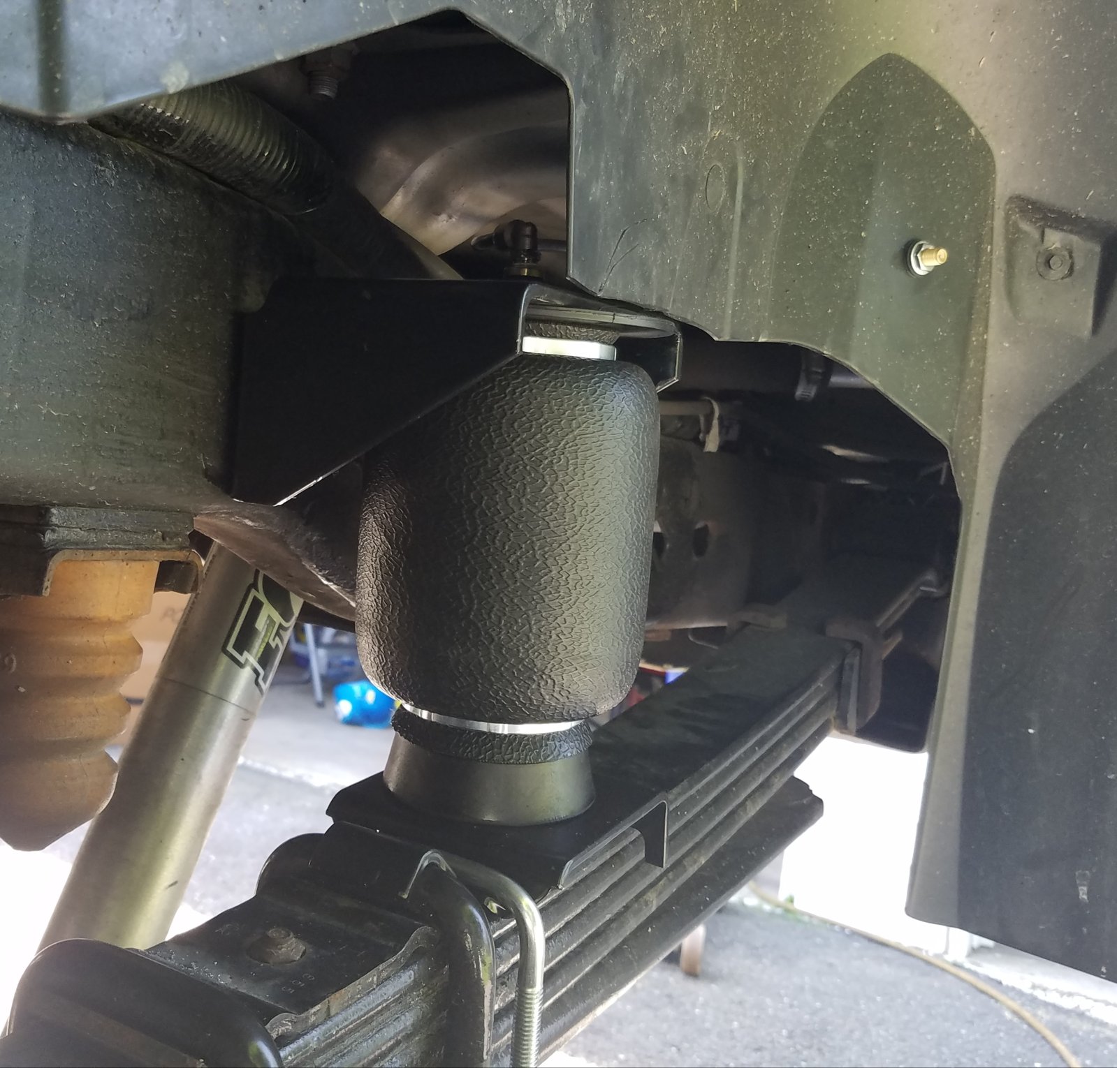

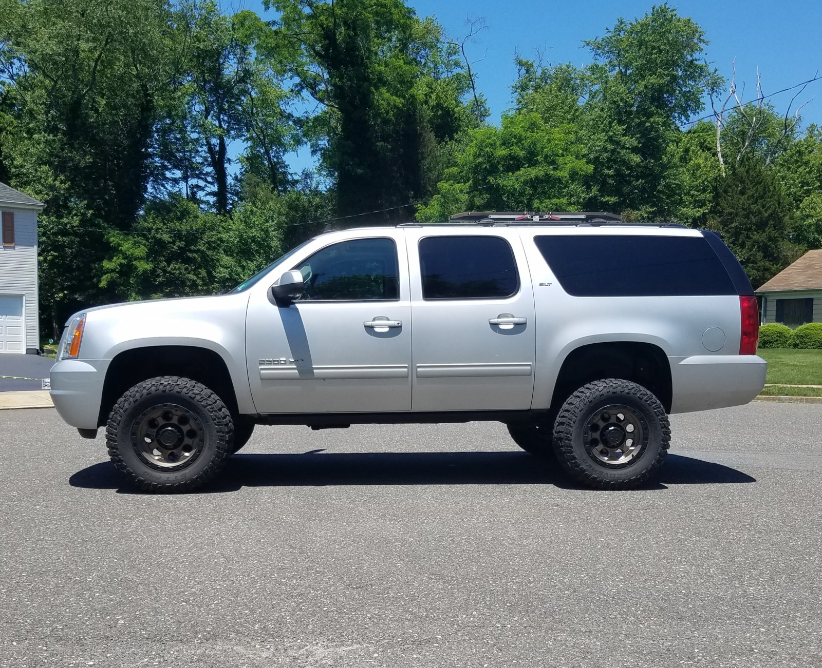

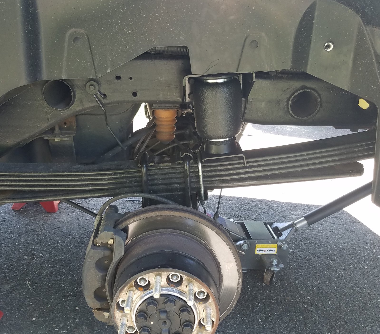

Next two upgrades going on are Crown Performance SS brake hoses, and Air Lift 59526 springs for the rear.
I decided to go with the SS hoses primarily for the rear lift instead of bending the stock steel lines. They're not here yet since they're made to order....
The air springs showed up and will be going on tomorrow or Sunday. Other than towing, they'll come in handy keeping the rear a bit higher with 39 gallons in the tank. I drop to just over 1/2" rake with a full tank after the lift, which means it probably looks like the rear is sagging when I hit the gas. I'm going to set the ride height with the air springs right at 1" rake with a full tank, and level driver/passenger lean, for DD duties.
