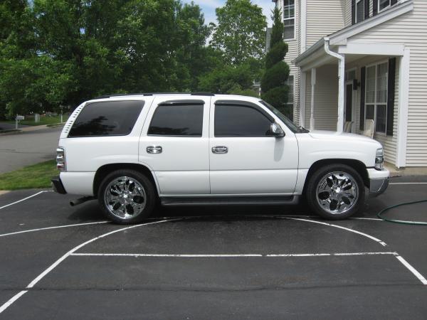

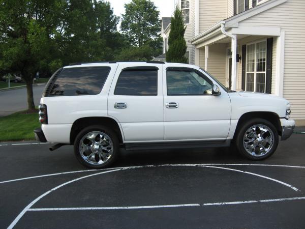

So finally wrestled up the funds to get the hoe lowered and found the Mcgaughys 2/3 lowering kit with keys in the front and shock extenders and coils in the rear on ebay. Still having some problems with the exhaust hitting the rear axle on some bumps. Will trimming the bump stop help at all? Here is a before and after. lemme know what everyone thinks
Before
After

is it the exhaust or is it the bump stops? Looks good man!
