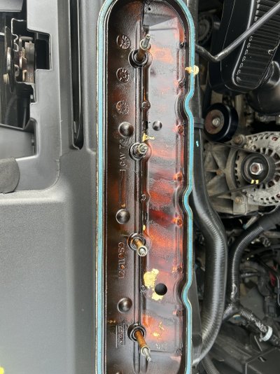

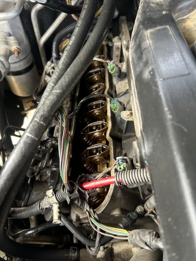

So did some more troubleshooting I guess you would say. Ran a compression test, probably should have started there. All the afm cylinders were low like 125-140 low while the other 4 were about 180-185. Pulled the valve covers and rocker arms were not sloppy and moved as they should while running. Plus side I have the pre tsb driver valve cover and will address that once the engine comes apart.
I'm thinking the afm switch or sensor what ever it is that controls that system, is failing or the valves have some serious build up. None the less ran some seafoam in the vacuum line and now letting it sit for a bit. Doubt that will clear anything up but you never know.

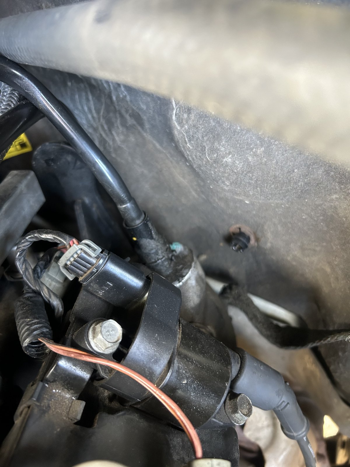

Is that PCV hose cracked or just an illusion?
