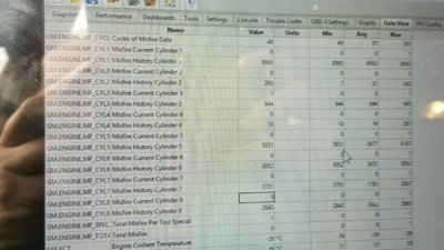

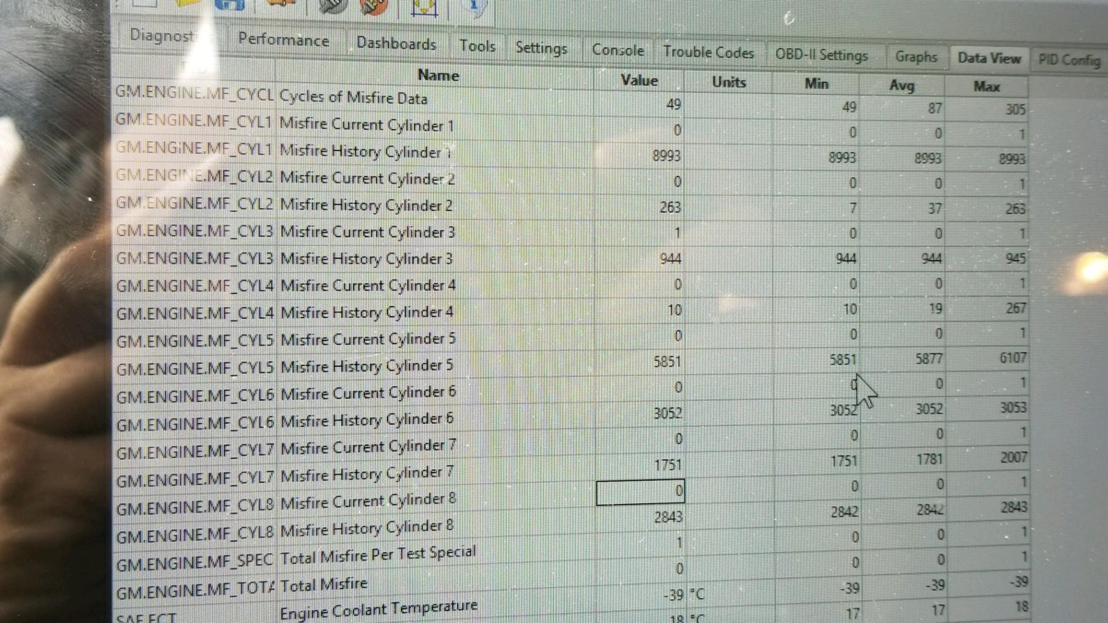

I've got an 03 Denali xl that is giving me misfire problems. Changed the plugs and wires before I had my buddy hook it up to his readers. Cheap reader gives P0300(random misfire) and P1380(misfires repeated) codes. His other reader is a little bit more in depth. Shows all the cylinders misfires. This cant be all the coils CAN IT? It's got to be further in then the coils right? Any input helps thanks

Also: I see it's -39 degrees where you are. If you have a flex fuel vehicle, e85 doesn't do well in the cold
The -39 was because I forgot to plug the radiator temp sensor back in. plugs are new and pre gaped as well as the MAF 6 months ago. It has 175K on it. Was also told the fuel filter or pump. How do I check the fuel pressure?

The engine coolant temp sensor can royally skew A LOT! The sensor can even keep a truck from starting. If the computer thinks it’s that cold outside it’s going to dump fuel to that engine to compensate. You need ALL sensors plugged in for proper data.
