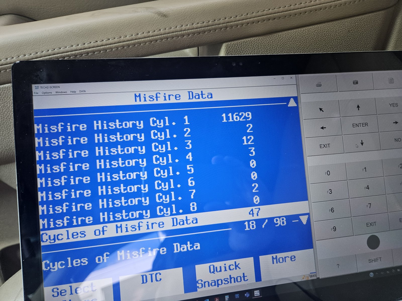

Ok so finally got around to hooking up the tech2 to watch misfire & these are the pics I took from today. Cylinder 1 seems the biggest culprit. Not sure if that's what's causing the occasional misfire from the others. Weird thought that I took a 6 hour drive to Atlanta sitting in traffic for a few hours & nothing happened. Truck ran great there & back. But as soon as Im driving back around town the misfire will randomly pop up. So the 9000 were when I started logging today, & ended with the 12000. Its weird though that it does it for a minute or 2 then back to normal & runs fine
Guess Ill get in there with a camera & see what I can see this week

Ok so I swapped coils with #1 &. #3 and the misfire followed the coil. So new coils. Should I just replace the one or do them all? And do I go with like an accel or granatelli vs stock if replacing all?

when I bought my truck it had one replaced. I think it's ok to just do one.
I think probably oem would be the best from rock auto, that's the standard recommendation but I've had horrible luck with oem gm parts being no better than anything else lately.

I grabbed a car quest premium coil from advance auto real quick. Swapped it in & so far today running the rest of my errands it seems to be running pretty well again. I also grabbed a other set of plugs but may wait until I do the cam in the near future & swap them in if the coil fixes my misfire

Nice detective work. I’ll betcha the coil didn’t like getting sprayed with coolant when the heater hose went.
