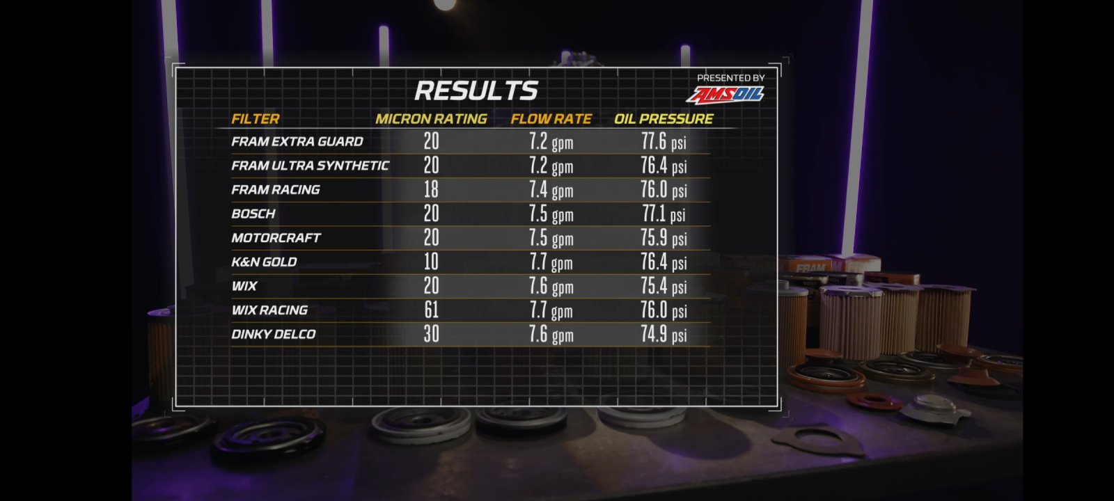

Gotta have prime video or motor trend to see it https://www.motortrendondemand.com/detail/oil-filter-shootout/1897867/
Basically Fram ultra is good, not the best but what I gathered is it's fine for a daily driver and will last a longtime. The cheaper frams are total garbage.
