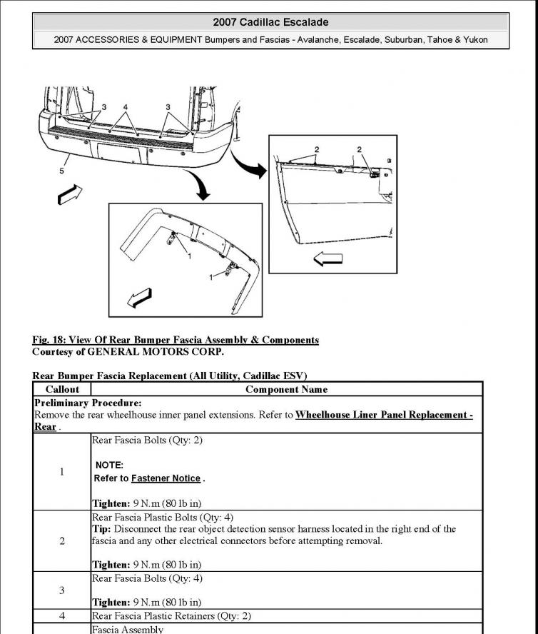

Your best bet in order to find OEM taillights is probably to check eBay. The trouble would be finding just one, but I always see them for sale.
I will attach a diagram for the rear bumper cover removal. I hope that will help!
Good Luck, and let us know if we can offer any additional help!

if removing the rear bumper takes you longer than 7 minutes, something is really wrong.
1/4" nut driver to remove the 4 screws across the back bumper, 2 on each side, two underneath (believe those are 10mm), two plastic retainers, and it just pops off.
I think I swapped my wifes bumper for the escalade bumper in about 15 minutes.
Yup pretty damn easy.
