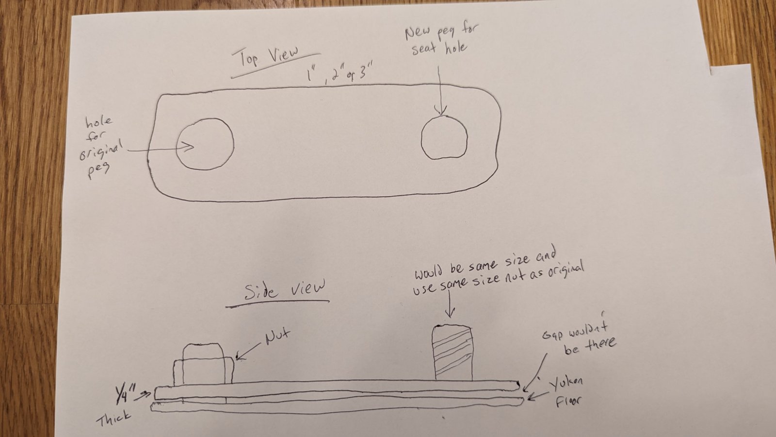

I know one of the rules in a forum is to not revive a 15 year old thread, but was thinking if a specially made metal rectangle piece that allowed for a hole in one end to slide over the original bolt and a threaded bolt the same as the original size on the other end of the rectangle (could be 1 2 or 3 inches offset from original) that the seat would sit on (like the original). Coat would be for the metal shop to make 8 of them (for each bolt) and 8 additional Nuts to secure them.
Does this hold water? It would make it so you didn't have to cut or weld anything onto the actual frame. Could just cut a slit in the carpet so you can get the metal piece under it (it'd be under the seat so no one will see the slit).
Bad drawing for reference.

Nevermind... Just realized it wouldn't work with the rear bolts, but I wonder if you could use that for the front bolts and then maybe drill a hole in the seat frame to line up with the back bolt. I'll have to take a look.
