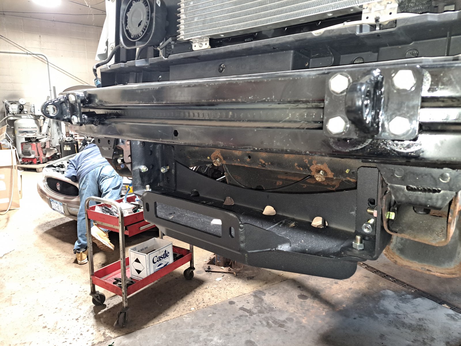

Update . I know its been a bit i got busy with other projects but Iam getting pressure to get the lift freed up in the shop.
Ok so I started working on the winch and bumper set up.
Parts 12k winch with remote control and wired,
winch plate Rough country for a 1500 & 2500 chevy pick up but used on a tahoe.
Rough country D ring mounts made for 1500 & 2500 pickups,

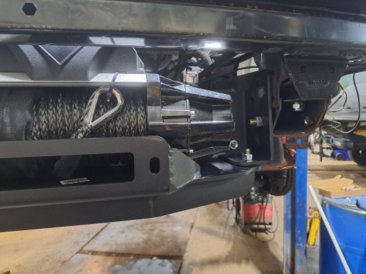

So i started by mounting the winch plate. They RC say it doesnt work on the tahoe I found it very easy. Just had to hammer the frame tabs that stick out a 1/4 inch flat so the side plates bolt up flat. you can see in the pic. I also had to drill 4 holes on each side to add the required bolts the pic doesnt show them all but it gets bolted to death.
Next i welded 1 1/4 inch spacers behind the upper d ring plates so the D ring mount would protrude the right amount out past the bumper facia. then i carfully mounted and marked the faicia and cut out the slots for them and the winch opening.
It really fit nice as you can see the winch face plate is low on the licence plate area thats due to the 3 inch body lift as the winch mounts to the frame. You can see the finished look.

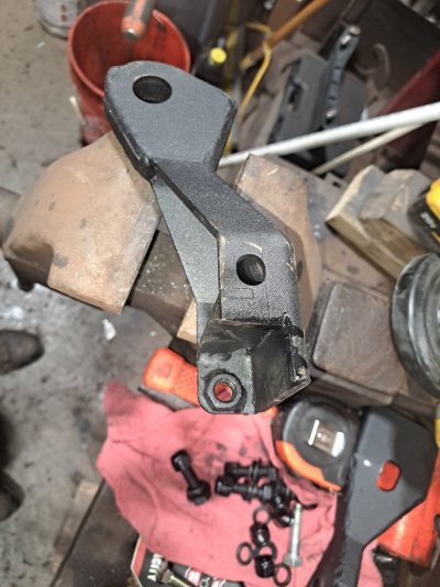

added pic on the RC D ring lower bracket that goes in the frame.
had to cut out the lower corner of the RC mount to clear when installed as i had to mount them upside down so they would stick up instead of down to line up with the opening as the 3 inch body lift raised the hook hole 3 inches. By mounting them upside down they line up coming out of the facia just right.
