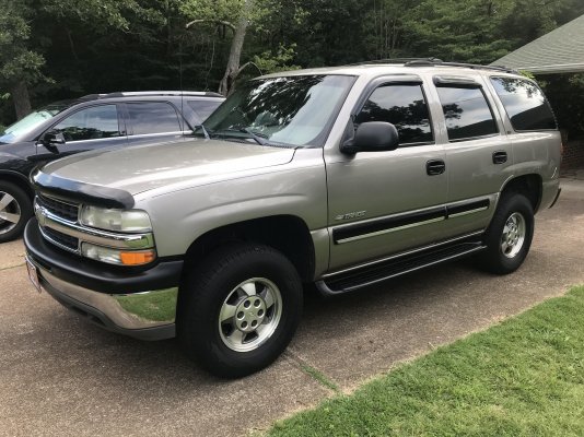

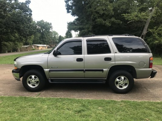

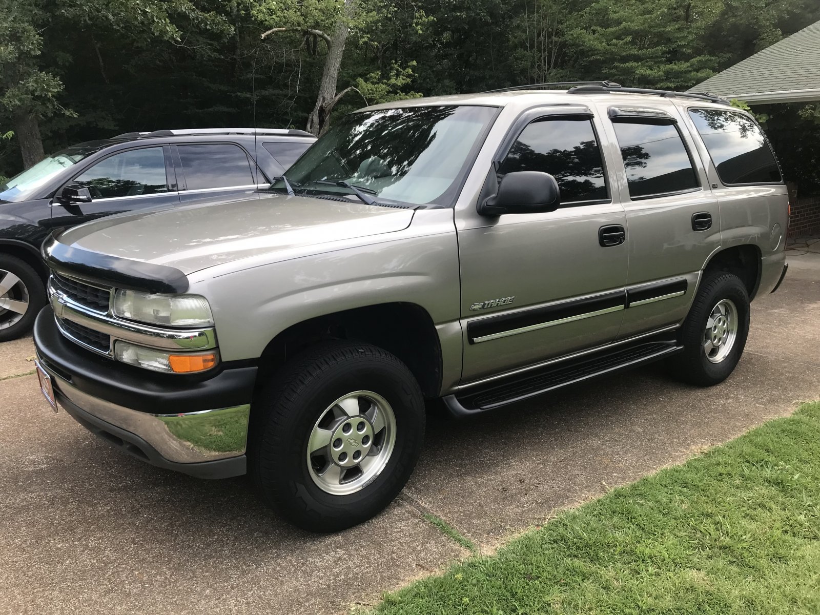

Welcome to the Forum from NH.
Pics of the truck, please.
You are already receiving sage advice from the knowledgeable folks on this Forum.
