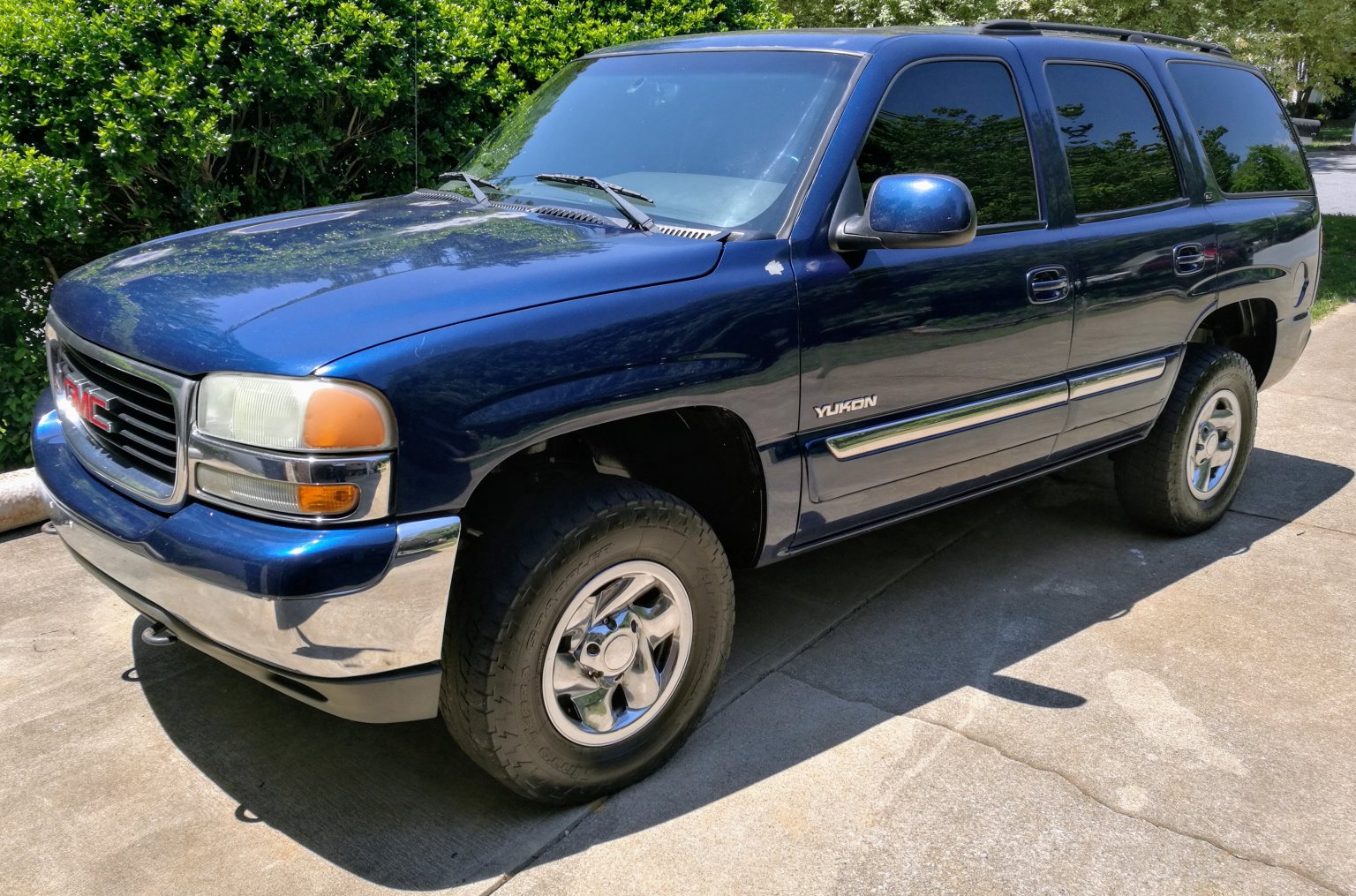

As it looked when I bought it:
It appeared to have had a leveling kit, which I saw as a bonus. Inside it had a single DIN JVC radio (originally a Bose car) and dark tinted windows. Beyond that, it largely seemed stock.

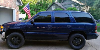

As it is now:
Anyhow, it is starting to be a labor of love, as it is nice being back in a GM truck. The steering is still not 100% where I want it. I may do the steering box adjustment (there feels like some play in it still) and then have it aligned again to see if that helps.
Until next time...
