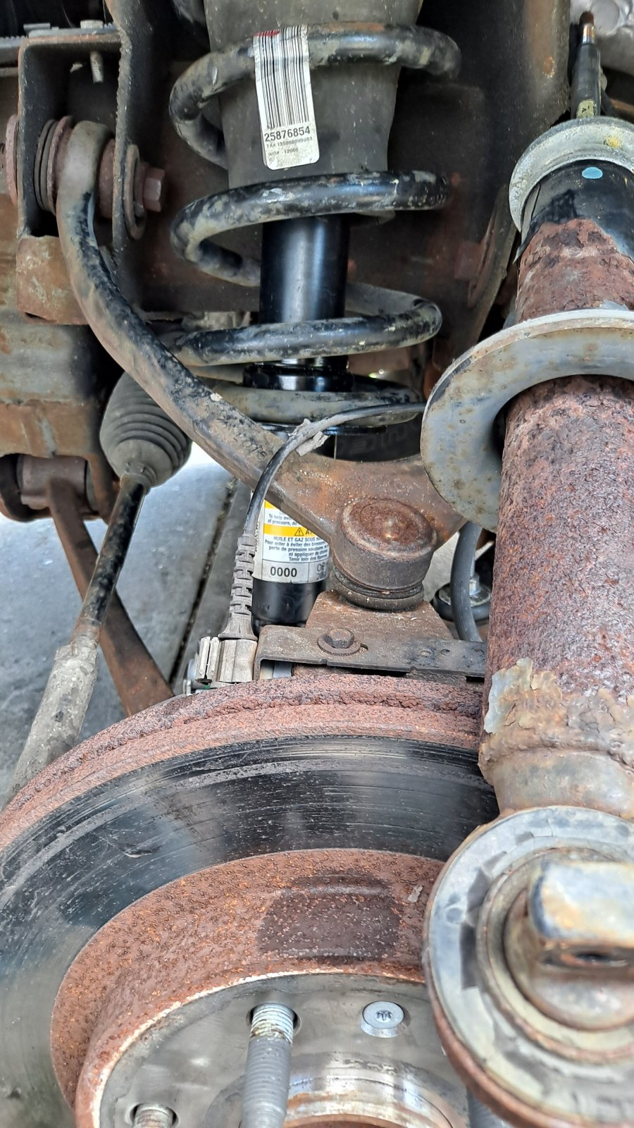

You can get complete replacement upper and lower control arms with new bushings and ball joints that will make the swap a lot easier for the diy guy with them being that cracked up I’d lean towards replacement
Last time I looked I think the lower arms were maybe 150$ a piece give or take
The uppers I’m not sure cause I ran aftermarket upper control arms
Thanks, I just really wasn't sure if they looked good or bad.
I was leaning toward pressing new ones in just to try something new. Ofc it's a lot cheaper too, but I figure if it goes South I could always order new ones.
I want to to the 2" drop spindle so I'll be keeping the stock upper arms.
I think the biggest pain would be replacing the ball joint as I think you need to grind the flange off.. Certainly if I were doing the bushings I'd do everything.
Probably a PITA but I like trying out new things. Plus I got an excuse to buy a press haha

The stock uca are a pain to change the ball joints out if their original is still lean toward just getting new arms you’ll thank yourself later for not having to fight it and deal with the headaches or waiting for the parts if something goes south while trying to get the old bushings and ball joints changed out

If you got a hydraulic press that would make things a lot easier
But again for buying a press you could use that money to get all new arms at the same price if not cheaper and you would be able to have the job done in a couple hours with the right tools then you’ll just need a alignment.
Check out dirt king fabs locking alignment cam plates also you won’t have to worry about knocking your alignment out with then vs the stock ones that like to come loose over bad bumps

Looked at the price difference for the lowers.. No sense pressing new bushings in. The ball joint itself is like $80, plus the bushings.. would save like $30 each. Not worth the hassle.
Didn't look at the uppers.
