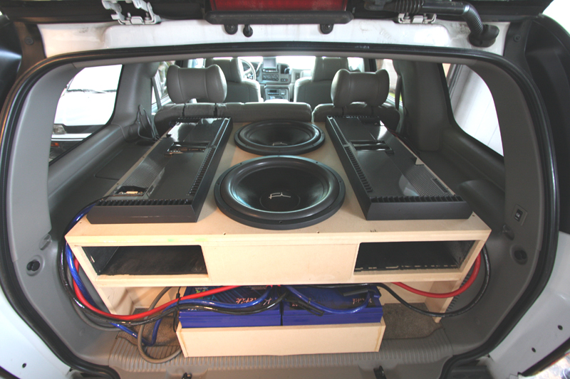

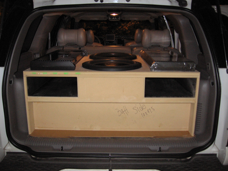

I wanted to build a 150db daily system that could hit a 150db on the Term Lab. I also wanted to build a non-wall / Below the window line box.
2001 GMC YUKON DENALI
SYSTEM INFORMATION
Head Unit: Alpine IVA-D100
Processor: Alpine PXA-H701/RUX-C701
CD Changer: Alpine CHA-S634
Screens: (2) Alpine TME-M710
Mids & Highs Amp: Rockford Fosgate T15004
Sub Amps: (2) Rockford Fosgate T4000.1
Front Mids & Highs: MB Quarts QSD-216
Rear Mids & Highs: MB Quarts QSD-216

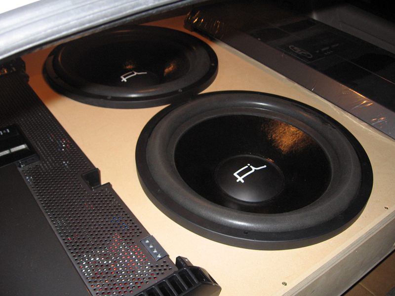

Subs: (2) 18" Fi BTL (Fully Loaded)
Electrical: Big 3 & 1/0 ga, (2) Yellow Optimas (3) Kinetik HC2400, Mechman Dual Alternator Setup (140+250)

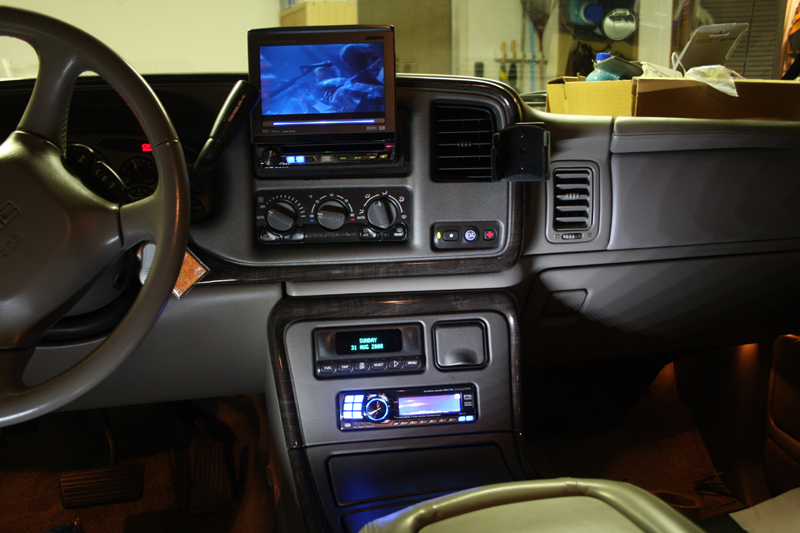

Alpine IVA-D100 and Alpine RUX-C701 Controller

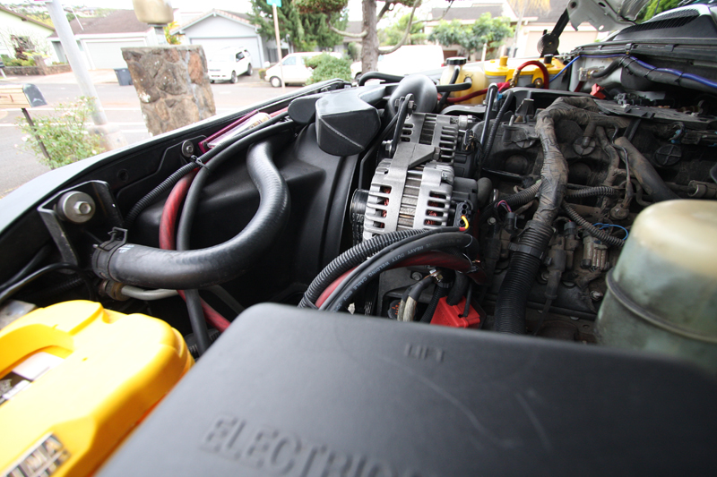

Mechman dual High Output alternator setup

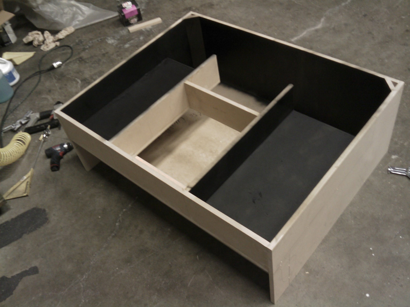

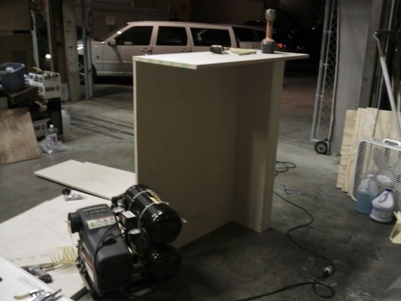

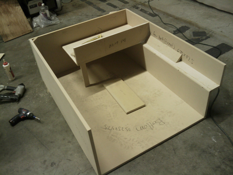

Box Build - If I remember correctly, it's somewhere around 12 cubic feet (after displacement) and ported to 35 hz

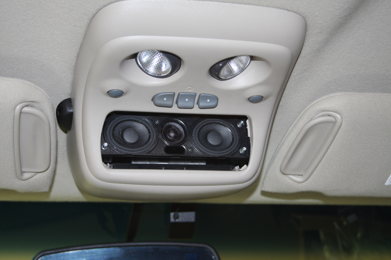

Center Channel Install

where did you relocate the rear ac/heat controls?
I hid it in the rear pillar right behind the panel. I set it on Rear control, so the rear controller works but the have to turn it on and adjust it.
